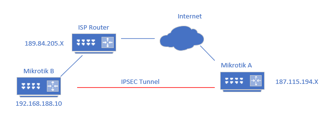

I’m tryning to setup a VPN with IPSec tunnel, but one site is behind a NAT:
The internet provider created NAT rules to redirect ports 500 and 4500 to mikrotik B. After making all the settings, the error “ipsec failed to pre-process ph2 packet” appears.

I read many posts about this problem, but not find any solution.
Any ideas?
Thanks a lot!

Any Ideas?
I implemented a VPN identical to this one with another mikrotik, and the VPN worked normally.
So, something on the ISP’s router is blocking connection with Mikrotik A.
I’ll check with ISP and return.
Thanks a lot!
I don’t think it is an ISP issue. What happens is:
10:08:16 ipsec searching for policy for selector: 192.168.19.0/24 <=> 192.168.80.0/24
given that the traffic selector is in accord with the policy you’ve posted in the OP, and that the policies are symmetrical (the dst-address of one of them matches the src-address of the other one and vice versa), my assumption is that the incoming IKE session has landed on a wrong peer. So the policy with a matching traffic selector does exists, but for another peer than the one chosen using identity. So the result is
10:08:16 ipsec policy not found
As no policy could be found using the traffic selector as a key, there is no way to find a proposal to use, hence
10:08:16 ipsec failed to get proposal for responder (and the NO_PROPOSAL_CHOSEN notification to the initiator).
So post /ip ipsec export verbose hide-sensitive from both machines, with properly obfuscated public IPs (properly means that all occurrences of each IP address are substituted by exactly the same string).
