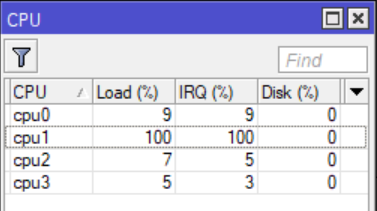

Everything seems to end up on cpu1, while 0,2,3 are <10% use. This is with 1 IPv4 transfer and 1 IPv6. Everything ends up on CPU1 for some reason.
Does not matter if we push traffic from a bunch of hosts to another set, across both protocol families. But it would help if we understood how traffic is distributed, then we can focus our efforts on a config that alleviates that single core from red lining.

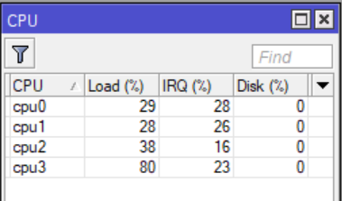

Here is an example when running without IPSec, load is nicely distributed:
MM
We did a bunch more tests and found it appears CPUs are assigned based on a hash of the src and dst peers addresses.
For example:
Concentrator: yyy.yyy.yyy.253
Client WAN interface IP:
xxx.xxx.xxx.252 results in CPU3 redlining under IPSec load.
xxx.xxx.xxx.254 results in CPU0 redlining under IPSec load.
xxx.xxx.xxx.253 results in CPU2 redlining under IPSec load.
xxx.xxx.xxx.246 results in CPU1 redlining under IPSec load.
I have not been able to determine the hashing algorithm that locks an established peer to a specific CPU, but its clear that is whats happening.

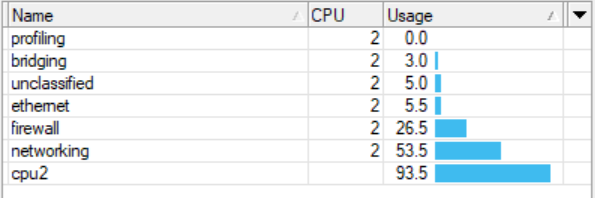

You saw one core at 100% - but did You found what was using it? I mean, we know there is something saturating one core - but we don’t know what it is. Can you test again, and post the usage by core/process?
Here you are. This is the profile for a CPU that is handling an IPSec peer, total IPSec throughput is roughly 140Mbit/s.
If i then add a second peer, one where the src / dst hash places the encryption process on another processor i get roughly double the throughput @ 280MBit/s and the profile looks like this:
That is just how IPsec is processed by this driver. It is not feasable to make a single IPsec stream/policy multithreaded as it will introduce latency, packet reordering and other unnecessary issues. You should still be able to achieve the advertised throughput if certain conditions are met, such as connection tracking should be disabled.
