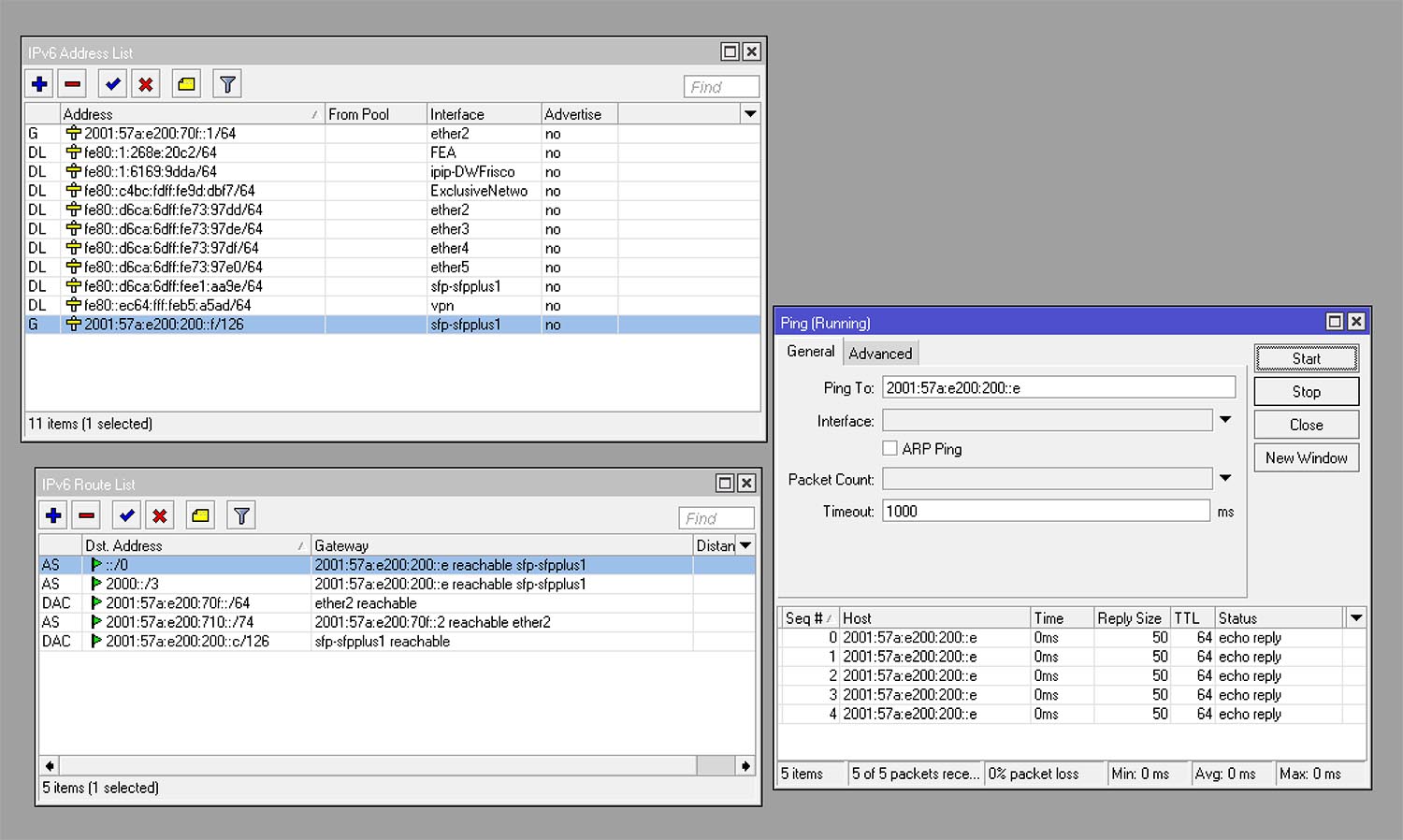

IPv4 works fine. IPv6 trying to get it setup and can ping my provider 2001:57a:e200:200::e but under IPv6 Routing the ::/0 says unreachable!
Currently we can’t route default ipv6 traffic back out because of this. What might I be missing?
See attached screenshot

Same problem, disabled ND, adding another static route and it still says 2001:57a:e200:200::e unreachable even though 2001:57a:e200:200::f/127 on sfp-sfpplus1 is in the same network and router can ping 2001:57a:e200:200::e
CCR1036-8G-2S+ running latest 6.42.3

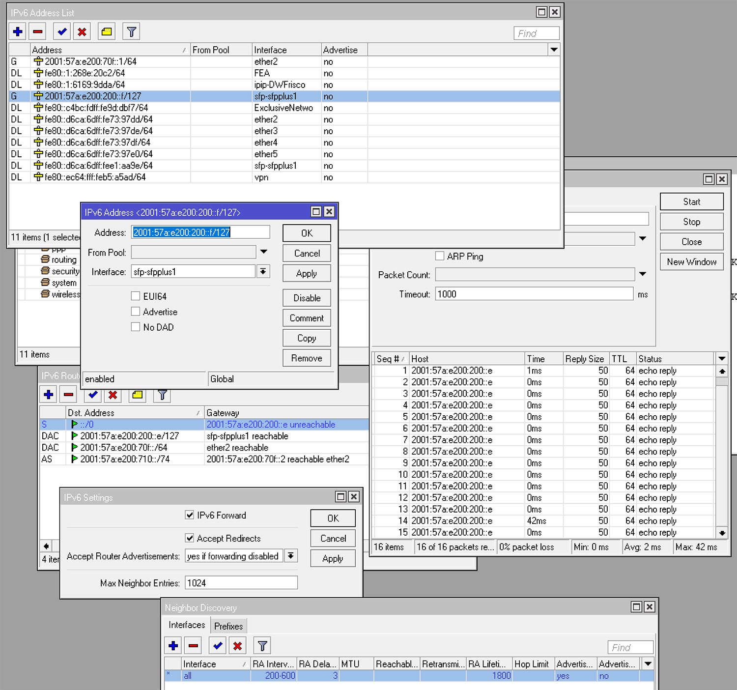

Either Cox Communications doesnt understand IPv6 subnetting properly or there is a bug in 6.42.3 when it comes to using /127
I’m assigned 2001:57a:e200:200::f/127
Provider has 2001:57a:e200:200::e/127 on interface
Mikrotik shows 2001:57a:e200:200::e is accessible via sfp-sfpplus1
Mikrotik won’t allow ANY static route (including ::/0) to use 2001:57a:e200:200::e, says UNREACHABLE
Mikrotik can ping 2001:57a:e200:200::e just fine
If I change my IP address binding from 2001:57a:e200:200::f/127 to 2001:57a:e200:200::f/126, Mikrotik RouterOS 6.42.3 is happy!
It looks like it’s RouterOS:
http://forum.mikrotik.com/t/ipv6-127/71778/1
