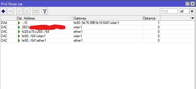

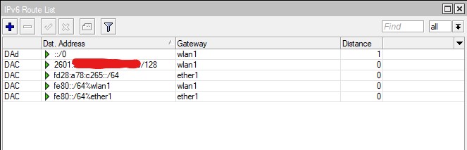

I noticed the difference between the routes:
after restart:
after dhcp disable/enable:
any ideas why it does not come as on the last picture after router restart?

the default gateway that is automatically added by dhcp client is different - notice the gateway field in the first route on both screenshots
after reboot it is missing ipv6 address
and ipv6 connectivity is not working I can’t ping google.com from the router for example

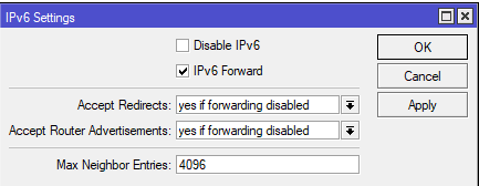

these are my ipv6 settings, it’s default on my router, and I’m using latest version 7.9.1
In that case it would only apply when IPv6 forward is disabled
So what am I supposed to change to make ipv6 work?

Change Accept Router Advertisments to yes

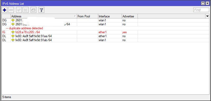

But now I have another problem,
after reboot it says duplicate address detected:
If I disable and enable the address it works.
So it’s a similar situation for me as before, now instead of toggling the dhcp client I need to toggle the ipv6 address.
OK I figured this out - enabled EUI64 on the address and now it seem to work after reboot.
