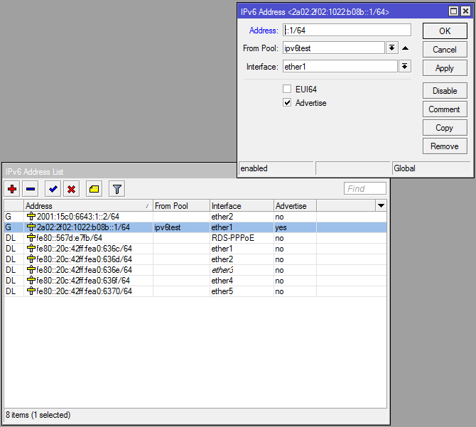

How did you assign from the pool to the interface ?
Nick.
If address is set to something like ::1/64, if the pool is populated, it will get the proper IP automatically, using prefix from pool | (or) address as defined. In my case, prefix is 2a02:2f02:1022:b08b::/64 from DHCP assigned to pool, so resulting address is 2a02:2f02:1022:b08b::1 and the associated /64 prefix is advertized on the LAN.
Assignment to local machines in the LAN is done via RA, and addresses are generated automatically using prefix + suffix derived from mac address.
