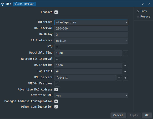

@bitflow This is what I have got with Google fiber ISP (connected on WAN1 - sfp-sfpplus1, nothing’s connected on WAN2-Failover) - hope this helps you. The setup is on CCR-2004-1G-12S+2XS setup to work as gateway router with services : hotspot, CAPsMANv1, CAPsMANv2, VLANs, etc.
It’s working correctly as desired so far.
IPv6 SETTINGS:
/ipv6/settings/print
                     disable-ipv6: no
                          forward: yes
            multipath-hash-policy: l3
                 accept-redirects: yes-if-forwarding-disabled
     accept-router-advertisements: yes
  accept-router-advertisements-on: all
       disable-link-local-address: no
   stale-neighbor-detect-interval: 30
           stale-neighbor-timeout: 60
             min-neighbor-entries: 4096
        soft-max-neighbor-entries: 8192
             max-neighbor-entries: 16384
                  allow-fast-path: yes
            ipv6-fast-path-active: no
           ipv6-fast-path-packets: 0
             ipv6-fast-path-bytes: 0
            ipv6-fasttrack-active: yes
           ipv6-fasttrack-packets: 731772
             ipv6-fasttrack-bytes: 972189037

IPv6 ND:
/ipv6/nd/print
Flags: X - disabled, I - invalid; * - default
 0 X* interface=all ra-interval=3m20s-10m ra-delay=3s mtu=unspecified reachable-time=30m retransmit-interval=unspecified ra-lifetime=30m
      ra-preference=medium hop-limit=unspecified advertise-mac-address=yes advertise-dns=yes managed-address-configuration=yes
      other-configuration=no
 1    interface=ether1 ra-interval=3m20s-10m ra-delay=3s mtu=unspecified reachable-time=30m retransmit-interval=unspecified ra-lifetime=30m
      ra-preference=medium hop-limit=64 advertise-mac-address=yes advertise-dns=yes managed-address-configuration=yes
      other-configuration=yes dns=fd99::1
 2    interface=vlan4-pvtlan ra-interval=3m20s-10m ra-delay=3s mtu=unspecified reachable-time=30m retransmit-interval=unspecified
      ra-lifetime=30m ra-preference=medium hop-limit=64 advertise-mac-address=yes advertise-dns=yes managed-address-configuration=yes
      other-configuration=yes dns=fd04::1
 3 X  interface=vlan8-guestlan ra-interval=3m20s-10m ra-delay=3s mtu=unspecified reachable-time=30m retransmit-interval=unspecified
      ra-lifetime=30m ra-preference=medium hop-limit=64 advertise-mac-address=yes advertise-dns=no managed-address-configuration=yes
      other-configuration=yes dns=fd08::1
 4    interface=vlan16-iotlan ra-interval=3m20s-10m ra-delay=3s mtu=unspecified reachable-time=30m retransmit-interval=unspecified
      other-configuration=yes dns=fd16::1
 5    interface=vlan12-vpnlan ra-interval=3m20s-10m ra-delay=3s mtu=unspecified reachable-time=30m retransmit-interval=unspecified
      other-configuration=yes dns=fd12::1
See also attached screenshot of Winbox for PvtLAN ND setup for your reference.
