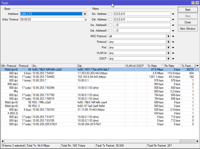

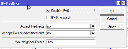

I have disable IPV6 but somehow, there are ipv6 which traffic flooding my local network.
When it’s happens all of clients can not connected to the internet.
i use bridge which consist LAN 1 dan LAN 2
Its happened randomly, not everyday.
Before this problem never occur, but this problem appears since some of user clients using apple device (ipad/iphone, etc..)
Thank you.
i put the screenshoot bellow.

IPv6 related settings do not affect bridging. So if LAN-LT2 and LAN-LT3 are in the same bridge, the frames carrying IPv6 packets are bridged between these ports regardless any IPv6 settings. Depending on your device model, it may be possible to prevent them from loading the CPU by letting a switch chip forward them in hardware, or by dropping IPv6 using switch chip rules. If the interfaces are 100 Mbit/s ones and there are no switch chip rules or no switch chip at all, you may use bridge filter rules to drop IPv6 traffic, hoping that the failing attempts to establish an IPv6 connection will occupy less bandwidth than a successful connection.

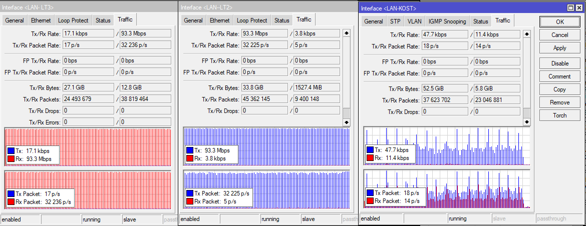

Dear Cindy,
New problems appears,

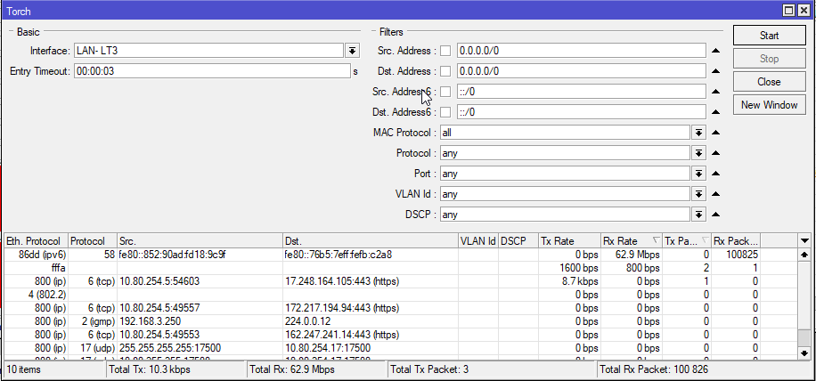

the code cures LAN2 and bridge from flooding but LAN3 still flooding.
here is the screenshoot.
any idea how to solve this ?..
Thank you.

@Znevna is right. If one of the connected devices floods the network with so much traffic even though it gets no responses, it is most likely infected by malware or broken (or its administrator has an evil intention himself). The drop rule in the bridge filter prevents this flood traffic from getting further to the network, but it cannot prevent it from clogging the interface bandwidth, so whatever equipment is connected to the same interface of Mikrotik like the source of the flood suffers from this as its own traffic doesn’t fit.
Thank you, @sindy & @Znevna,
After investigation, i found that the device are router AP Wifi which connect to LAN 3 port in mikrotik. I assumed it’s broken even so the IP4 & IP6 dhcp server is turned off and eventually no body connect to those router AP Wifi either. We change the AP everything is back to normal.
