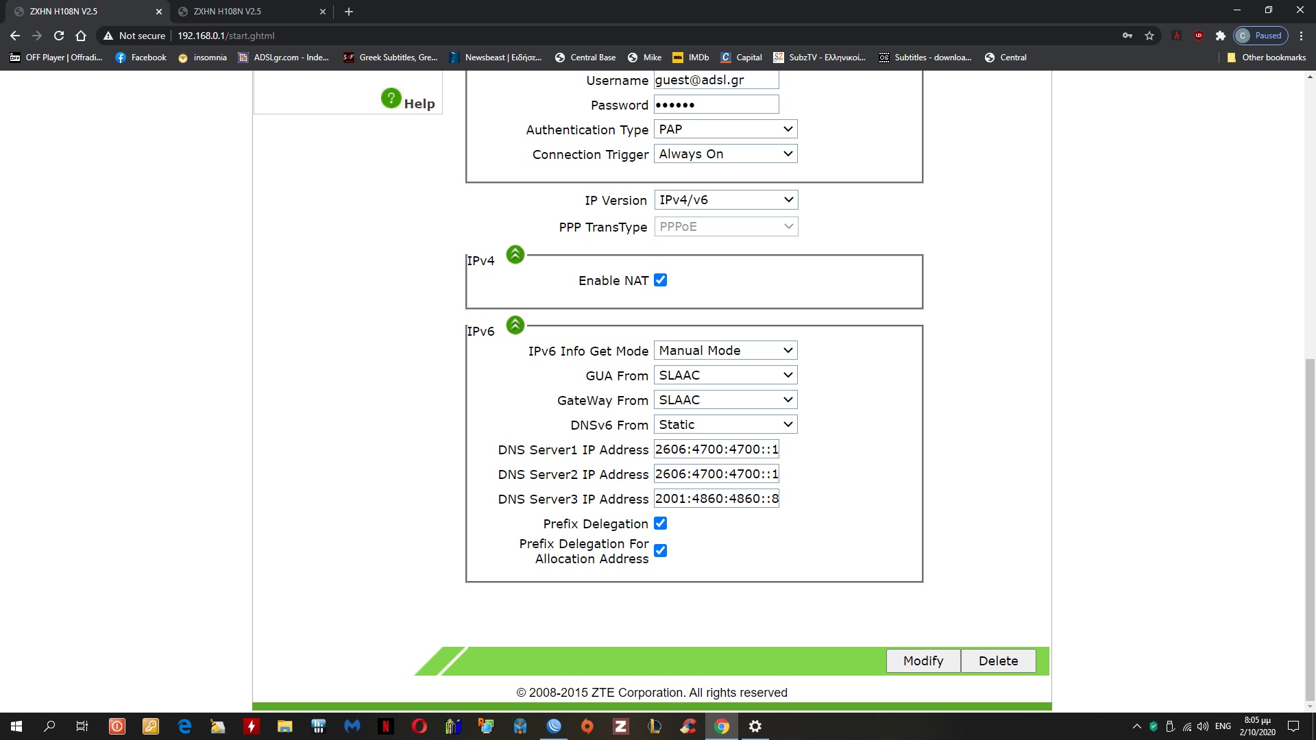

As i described in title, i have a crs109 behind a ZTE modem router which connects on internet and also has a working ipv6. RA and prefix delegation is enable in ZTE. Now my issue is that crs cannot get the ipv6 from the ZTE and the ipv6 dhcp client is on searching mode. ZTE is not in a bridge or passthrough mode for reasons that i cant explain now and they r connected as router behind router with DMZ in ZTE.

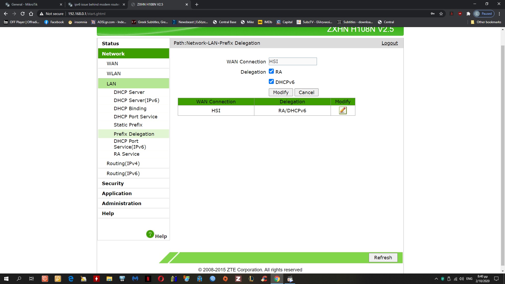

Look in ZTE’s Network->LAN->Prefix Delegation (or Static Prefix) menu, it could be the way how to delegate prefixes to LAN, and then RB’s DHCPv6 client could get one.
Also enable for wan connection. Static prefix is empty and may be that one is quilty i think. Should i set something there i guess?

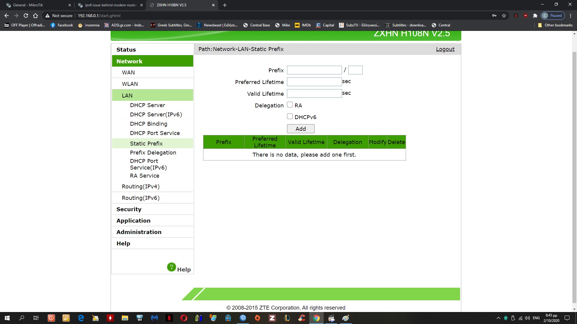

And people say that RouterOS is confusing… yeah, right, compared to this it’s clear as day.
I found manual (https://www.wind.gr/files/1/Wind_v2/statheri/epipleon_ypiresies/devices/ZXHN_H108N(V2.5)_Home_Gateway_Maintenance_Management_Manual.pdf) and it’s not very helpful either. It seems that this “Prefix Delegation” is probably related only to getting prefix from ISP and it can’t really delegate it further, only advertise it using RA or give out addresses using DHCPv6. Otherwise it wouldn’t make sense to have RA with DHCPv6 together, because RA can’t be used to delegate prefix.
Although your config may not be correct either. If DHCPv6 client on RB does not get any prefix, then where those ipv6-pool-WANx pools come from? And why they are completely different from /56 on ZTE? Also, why they are advertised on WAN ports?
How scan i make a new pool? can u or someone, give me the script according to the screenshots above? I also set in zte>lan>static prefix the 2a02:85f:2e01:6400::/56

I also added this in zte but still no luck… any ideas r welcome
After reading the ZTE manual I think there is a typo or a poor wording in chapter 6.3.6 where the first “WAN” should actually read “LAN”. It seems quite logical that PD must be permitted on WAN side in order that the router could further delegate prefixes to client routers on LAN.

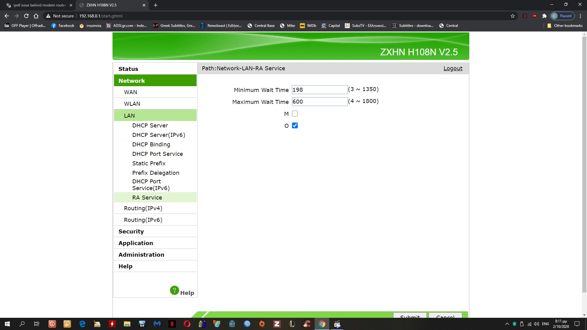

So it now depends on whether there is some bug there, or whether the ZTE expects something that Mikrotik doesn’t provide in the received Solicit message to send a reply containing a prefix. I would first try to disable the RA option in the prefix delegation setting at LAN side (and leave just the DHCPv6 one ticked), and I would try all three combinations at the WAN side (only Prefix Delegation ticked, only Prefix Delegation for Allocation Address ticked, and both ticked). I would also reboot the modem after each change. And I would definitely remove the manually configured prefix from the ZTE settings as the first step.
