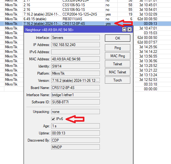

So, I have a bunch of Mikrotik devices, and aldo I disable IPv6, and IPv6 Neighbor Discovery on a particular device (let’s say device A), when I go to other MikroTik device, device B, in Winbox IP - Neighbors, in column IPv6 it says for device A - “yes”.
How can I disable IPv6 on device that it do not shows as enabled in Neighbor Discovery ?

I don’t know if it is appropriate to publish MikroTik support correspondence, but I rasied a support ticket with MikroTik support, and got this answer:
Me: If I disable a IPv6 support on a MikroTik device A, it shows as enabled in Winbox on IP / Neighbors List on device B.
Support: This flag represents that the system is capable of using IPv6, not that it is currently using IPv6.
We will consider if it might benefit to use “current” IPv6 status, not “potential” status.
Me: Thank You for clarifying the issue, and also, You might want to update MikroTik Manual, where it is stated:
ipv6 (yes | no) Shows whether device has IPv6 enabled.
https://wiki.mikrotik.com/Manual:IP/Neighbor_discovery
That is some contradicting information, what You told me, and what it says in Manual.
Support: We will consider simply changing the flag behaviour and represent actual status. This was just fine in v7 where IPv6 had separate package and its existence decided if IPv6 is running or not. Now it is IPv6/Settings.
