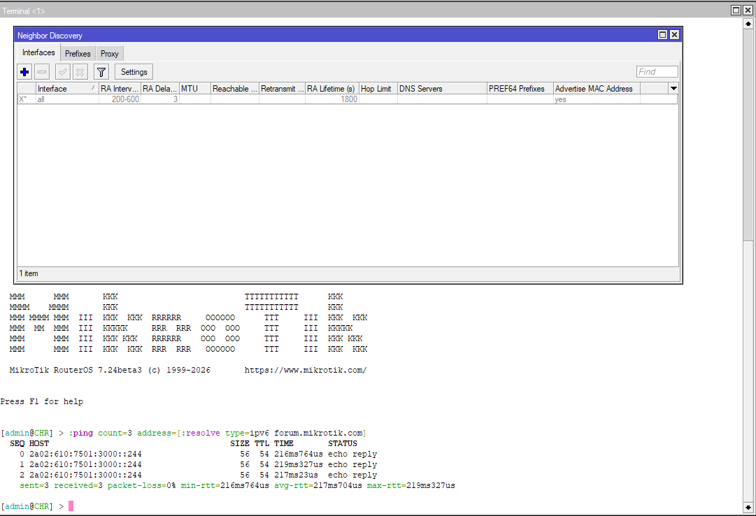

So you can disable the default entry in ipv6/nd (so it not send out RA/RS) without breaking ipv6?
Yes, to be sure before writing the reply above, I did empty the /ipv6 nd table of my test CHR, disabled the default all entry and rebooted. Afterwards the CHR still gets a SLAAC address on ether1 as well as a default route from the parent router and can contact IPv6 hosts on the internet normally.
Of course, we are talking about the IPv6 connectivity of the RouterOS device itself. It will not be able to act as a router for other devices without /ipv6 nd entries. But that's fine if it's only a switch or dumb AP.
