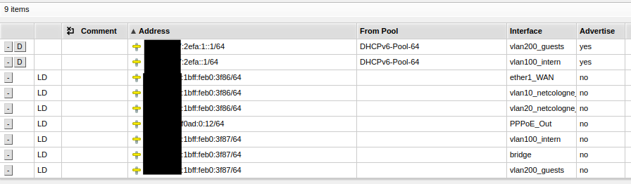

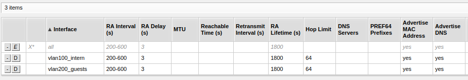

I have IPv6 prefix delegation running via PPPoE and would now like to use this for several VLANs.
The current status without VLANs with IPv6 looks like this:
As soon as I try to define further IPv6 addresses, an address duplicate is recognized. What would be a sensible configuration here?
Thank you very much
The simplest way is to set “address=::1/64 from-pool=DHCPv6-Pool-64” … don’t try to set a more specific address. If set thusly, pool will hand out addresses with different /64 prefix each time interface pulls another one.
This is how I created the entry, but I don’t know how to use the procedure for multiple VLANs. The pool gives me the same address again.
I kept adding similar config lines for other vlan interfaces. And worked for me.
What version of RouterOS do you run? There was (?) a bug where RouterOS incorrectly recognized suffix addresses as duplicates and removed all but one.
Many thanks, it seems to work now. The error was on my side, I used “:1/64” before instead of “::1/64”.

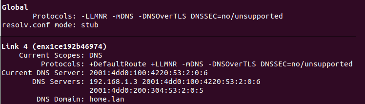

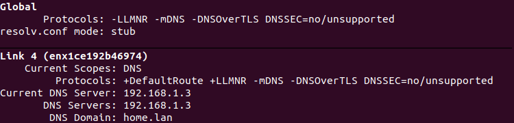

Currently I still have problems with the name resolution, probably only with Linux clients.
If I activate IPv6 → DHCP Client → “Use Peer DNS” in ROS, the Linux clients probably prefer to use the IPv6 DNS server transmitted by the ISP. As a result, local host names are no longer resolved.
I deactivated the “Use Peer DNS” entry as a test, then the local name resolution worked again (via the IPv4 DNS, which I distribute via the IPv4 DHCP server.
I am not sure whether this procedure makes sense. How does it actually differ whether a DNS v4 or v6 server is used when a client resolves a hostname? Can I overwrite the advertised IPv6 DNS from the ISP (e.g. go to a local Adguard Home Instance)? If yes, how?
