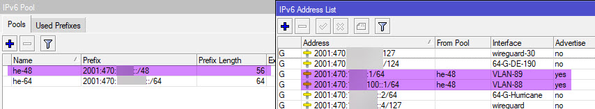

Maybe you could enlighten me as to why the pools in the below config overlap? They’ve got different prefixes so I’m not sure what I’m missing…
My WAN pool has been assigned by my ISP via DHCPv6 as (for example) 2a00:0:0::/48. If I then try to create a second pool statically called LAN as 2a00:0:0:0::/64 I get the error mentioned in my original post stating “Prefix of two pools cannot overlap”
I know I don’t necessarily need multiple pools since I can get /64s from the WAN pool but it would be useful to know.

Well, they overlap because 2a00:b847:36:1::/64 resides in the same space as 2a00:b847:36::/48. If your ISP gave you 2a00:b847:36::/48 and gave someone else 2a00:b847:36:1::/64, their routing system would be messed up.
In RouterOS, pools are an address allocation/bookkeeping mechanism. The RouterOS code behind the “new pool creation” mechanism is detecting that you are double-allocating an address range and trying to protect you from a configuration that is not something it can reasonably keep track of.
