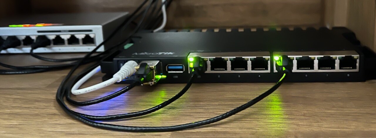

I ended up going for the RB5009UG+S+IN. While PPPoE has been rock solid ever since, and I am now able to max out the 1Gbps WAN @ 45% CPU utilisation, the SFP+ has been a let-down.
There is not much more to tell about the PPPoE WAN connection: it just works.

After 6 months+ of running the RB5009, I like it - especially the fanless part. Apart from SFP+, it mostly works as expected (there is at least one other thread in here which I am leaving for another time). If I had to do it all over again, I would get the POE version, specifically RB5009UPr+S+IN (it was not available 6 months ago).

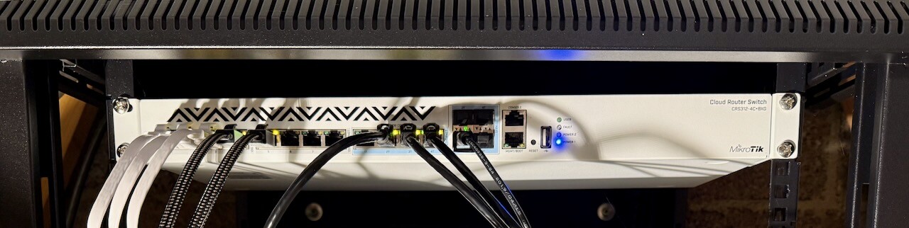

The only significant network equipment that I added in the last years was the CRS312-4C+8XG-RM which is the core switch for all 10Gbps-capable devices. It’s a fantastic piece of kit! Once I got some proper CAT6A cables for the long runs, and CAT7 & CAT8 for the short runs (including patch cables) I had 0 issues since (2+ hassle-free years). Cables are super important important. I had issues with some thin & fancy patch network cables that looked good (like the ones on the RB5009), but ended up introducing instability in the network (packet loss, random connection drops, etc.).

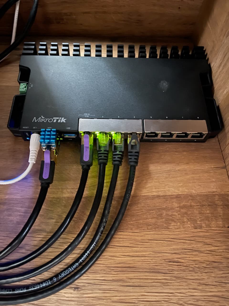

As for the S+RJ10 module that I mentioned previously, I ended up fitting a few tiny Pi Zero heatsinks. While it still ran hot - ~80C - after years of use, it turned out to be OK.

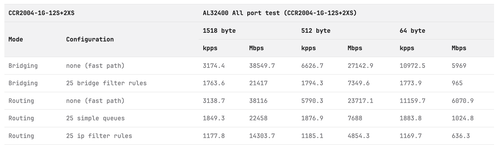

  1. CCR2004-1G-12S+2XS
  2. CCR2216-1G-12XS-2XQ
  3. RDS2216
Considering the price of 2 & 3, the only sensible alternative for a 5Gbps WAN and 10Gbps LAN is the CCR2004.

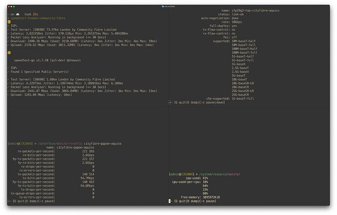

I now have the CCR2004 finally set up, the 10Gbps capable WAN uplink is running on one of the SFP28 ports via the S+RJ10 and while I am still waiting for 5Gbps to become available, here is a speedtest on the 2.5Gbps WAN to see how much CPU pressure this puts on the CCR2004:
To be honest, I was not expecting the CCR2004 CPUs to run at 41% utilisation across all cores, with 2/4 cores at 66% capacity for 2.5Gbps WAN. That PPPoE penalty seems to be more significant than I initially thought…
I have FastTrack enabled, and I have confirmed that the packets are using it, but this makes me wonder if the 5Gbps WAN is going to be as much as the CCR2004 is able to handle. Given that 2.5Gbps use 41% of the CPU, simple math makes me assume that 7-8Gbps PPPoE WAN is the most that this router can handle. If I am still running the CCR2004 by the time I get the 5Gbps upgrade, I intend to circle back with those numbers.

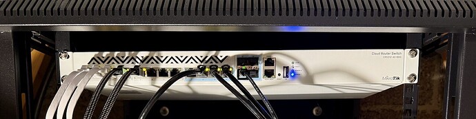

As I take a step back and consider upgrade paths, I wanted to share one last picture from 2025, with my network cabinet that got some care & attention over the winter holidays (even though that patch panel needs an entire strip-down so that ports can be re-arranged - they are all over the place):
