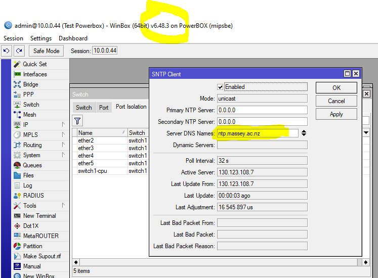

In SNTP Client, you can use “Server DNS Names” to enter a domain name, like pool.ntp.org .
https://help.mikrotik.com/docs/pages/viewpage.action?pageId=40992869

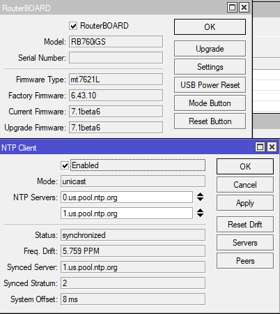

Yes - 7.1beta6 feature.
Proof:
Also on RoS 6.48.3 and earlier
The problem with RouterOS version 6 is that when you install the optional NTP server package, it also replaces the SNTP client, and the new NTP client is much more limited… (only 2 server addresses, only as literal IP address and not as DNS name).
In RouterOS version 7 that problem is no longer present, as the server is now part of the standard install and the supplied client is much more flexible.
It can use several servers and they can be specified as IP address or DNS.
