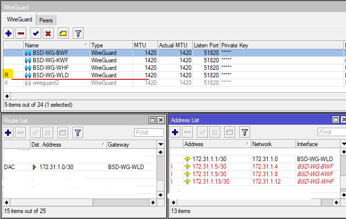

Is multiple wireguard interface possible?
Is multiple wireguard interface (each with its own site-to-site peer connection) possible? I have seen examples of One interface with multiple peers, but not multiple interfaces for multiple peers. I tried it but it seems that only 1 interface is running as shown in the picture attached. Also, the IP addresses all shown invalid except for the one assigned to the running Wireguard interface. And the dynamic route is created automatically. No peers are set up at this stage.
You can’t have all of them listen on the same port, obviously.
Yes, of course its possible but one has to be careful ON THE SAME WG INTERFACE, not to have overlapping peers (allowed IPs).
In such instances it actually makes sense to break out an additional WG INTERFACE.
Thanks for the tips, the unique listening port number fixes it. Cheers
Yup, covered in para (2),

(1) Okay quickly looking at the config, it appears you have two accounts with third party VPN.
In addition you host WiREGUARD for remote access to your router.
(2) Lets look at WG settings - seem okay!

(3) Lets look WG peers. PROBLEM

Okay so you have 4 outgoing connections to wireshark, 1 to wireshark2 and 3 incoming to MT wg-rw.
Now this just proves to me you have not read the link and do not understand Allowed-Addresses!!
Read, think and come back and tell me why your wireguard-surfshark will not work!!!
Hint it will only work for Madrid.
(4) Lets look at IP addresses: Problem>>>>>>
add address=192.168.87.1/24 comment=defconf interface=bridge network=
192.168.87.0
add address=192.168.77.1/24 interface=bridge-guests network=192.168.77.0
add address=10.14.0.2/16 interface=WG-Surfshark network=10.14.0.0
add address=192.168.50.1/24 interface=Wireguard-rw network=192.168.50.0
add address=10.14.0.2/16 disabled=yes interface=WG-Surfshark_2 network=
10.14.0.0
Its not unsual to have multiple IP addresses on an interface but very unusual for wg.
You really should have two separate interfaces… if they have truly given you a /16
Then use…
add address=10.14.1.2/16 disabled=yes interface=WG-Surfshark_2 network=
10.14.0.0

In summary the config is confused, the purpose of third party VPN is not clear and is causing issues.
What is the norm.
ONE WIREGUARD INTERFACE, ONE IP ADDRESSS, ONE ENDPOINT.
Two use another endpoint means a separate wireguard connection so need
another IP address and wireguard interface to go along with second endpoint.
In your case suggest seeing if you can use the /16 address provided 10.14.0.2/16
wg1 10.14.0.2/24 network=10.14.0.0 Previous peer1 surfshark endpoint1
wg2 10.14.1.2/24 network=10.14.0.0 Previous peer2 surfshark endpoint2
wg3 10.14.2.2/24 network=10.14.0.0 Previous peer3 surfshark endpoint3
wg4 10.14.3.2/24 network=10.14.0.0 Previous peer4 surfshark endpoint4
wg5 10.14.4.2/24 network=10.14.0.0 Previous peer1 surfshark2 endpoint5’

In other words, If I want to shift from Madrid to Netherlands VPN server, I just deactivate one peer and ativate the other. Is this not correct?
I’ve tried, and both IP’s work, but not at same time. Surfshark provided me with this one: 10.14.0.2. You suggested to use 10.14.1.2 for setting-up a second WG interface.
Maybe Surfshark can see it?
I’ll go in deep through your comments on my Firewall rules, very interesting.
Thanks,
Ahh okay so rotating depending upon country of choice…
If they only gave you one IP address /16 I would be interested to see what happens if you try a second one.
Are you saying that surfshark2 is something different, or something you are no longer using? It suffers from the same issue, same IP address etc…
Nothing happens. IP Address table shows IP row in red color. See picture:
Using the wrong address format.
10.14.0.2/24 s1
10.14.1.2/24 s2
Correct, I was wrong. I went again through your first post. Tried again. But it’s not possible to keep address = 10.14.1.2/24 and at same time network 10.14.0.0.
Mikrotik automatically changes Network IP when clicking apply.
Not sure what you mean but MT has no say in the matter LOL
It should be entered like so…
add address=10.14.0.2/24 interface=surfshark network=10.14.0.0
add address=10.14.1.2/24 interface=surfshark2 network=10.14.1.0
That is correct both fall under 10.14.0.0/16 so not to worry.
Hello Malabar,
I haven’t read the whole conversation, but I think your error comes from the fact that you have two WG interfaces on the same listening port (51820).
When I replicate this, I get in the “Could not create IPv4 socket” message. Open your log window, disable both interfaces and enable the WG-Surfshark_2 interface 1st, then the other one You should see the same message and WG-Surfshark’s IP address will now be red .
The reason that your interfaces work in alternance is that the 1st one to come up is OK then the 2nd fails because of a duplicate port being used.
Cheers,
