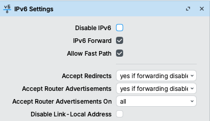

  • “Accept Router Advertisements On” setting defaults to “all” in ROS, should that be disabled on my ISP interface since I’m getting a prefix through DHCPv6?
  • and what might the implication be with Accept RA disabled on the interface facing my ISP?
Accept Router Advertisements On ‘all’ is the default, BUT
Accept Router Advertisements ‘yes if forwading disabled’ is also the default. It seems you’ve changed this. Why?

As for the need for /ipv6 settings set accept-router-advertisements=yes:
  • If your WANs only use PPPoE clients or other types of point-to-point connection, then you should keep the default accept-router-advertisements=yes-if-forwarding-disabled.
  • You have WAN interfaces that don't use PPPoE but use DHCP or static IP address on the IPv4 side, then you'll need accept-router-advertisements=yes.
    But it's preferable in that case to not keep accept-router-advertisements-on=all. Instead, create an interface list that contains only the non PPPoE WAN interfaces, then use that interface list as value for accept-router-advertisements-on=.
DHCPv6 normally do not provide the gateway / default route information. The gateway information must come from other sources. In case of point-to-point connections like PPPoE then the gateway is known to be the other side of the link. But if the WAN link is only ethernet, then you need to accept router advertisements.
Note: There is a hack from MikroTik that allows you to keep not accepting router advertisements. It's the "Add Default Route" checkbox in the DHCPv6 client setting. However this is not based on any real standard, but it's only RouterOS taking the address of the DHCPv6 server and use it as gateway address. Which might be the right address or not, depending on the ISP.

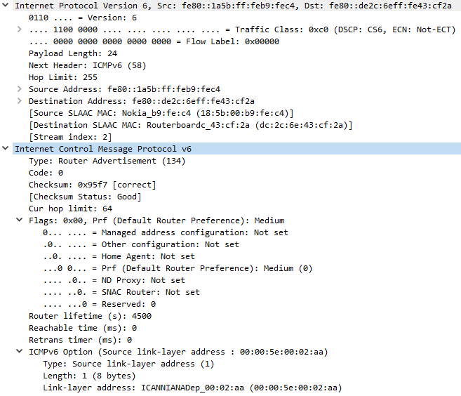

They send RAs with M and O unset (the RA contains nothing else) AND they give me a prefix and an address via DHCPv6, obviously no route installed if I uncheck ‘add-default-route’ in the DHCPv6 client.
I still think that they need to set at least managed-configuration in the RAs.
Yes, they should set M when they give out address via DHCPv6. But this is not related to the default route. If RA lifetime is positive then the default route should be installed, regardless of whether there is any prefix (in RA message) or DHCPv6 server available.
My ISPs set M but nothing else. 7.22rc1 has improvements that fix my particular error. Curious if yours is addressed as well.
Nope, and I don’t think that it should install a route in this case.
If the RA doesn’t contain a prefix and M=0 the router thinks that it has no reason to install a route since there’s no public prefix offered. Even if my ISP does provide one via DHCPv6. Probably MikroTik stops at does RA contain prefix? -no; ok, does it have M=1? -no; = K, NO ROUTE FOR YOU;
Even if it does contain router lifetime > 0.
They don’t check if the interface has a public IP.
And I don’t think they should change this behaviour.
I’ll keep bitchin to my ISP to fix their routers.
Nokia defaults M/O=0 for some reason and it looks like they didn’t bother changing the defaults.

So you say that MikroTik should install a route even if the RA looks like this?
Yes, the router lifetime is advertised as 4500s (and has RA Preference Medium), so according to the RFC, fe80::1a5b:ff:feb9:fec9 should be added to the default router list. And a default router by definition provides a default route. The list in this case would also have only one item because no other host is sending RA.

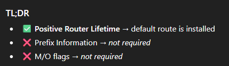

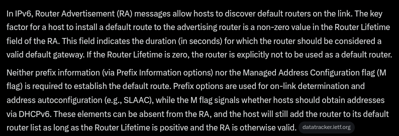

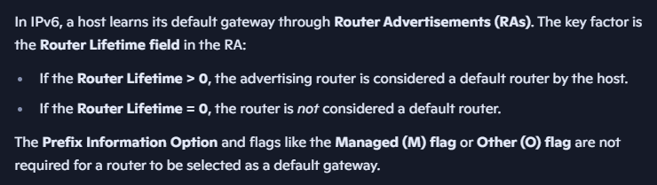

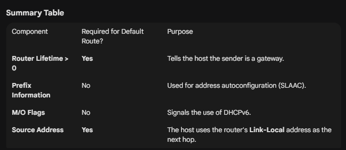

Edit: We can open any of the major AI providers and give them this question:
Does ipv6 the router advertisements message need to have the prefix information and management flag to have a default route, or only a positive router lifetime suffices?
and they will all confirm that only RA Lifetime > 0 is required, neither the Prefix Information Option (PIO) nor the Management flags are needed. In this case I don't think that they all hallucinate and give out the same false information :wink:
