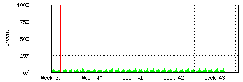

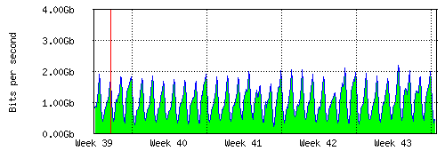

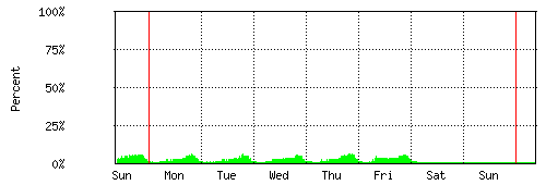

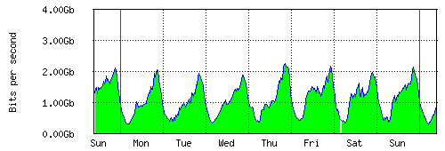

Over the weekend I upgraded my CRS328, CRS317, and CCR1036 to 7.6. The 317 and 328 are simply switching. The CCR1036 is running BGP and OSPF internally, alongside a half-dozen smaller boxes (RB5009, RB4011, CRS310/NetFiber 9), and performs CGNAT at 1-2Gbps for roughly 500 end users.
After reading on a number of other posts about improved tile performance, particularly on 1036’s, I decided to upgrade them.
Here are the CPU weekly and monthly graphs for the CCR1036. You can see the load drop from 3-9% curves to 0% Saturday morning:
Here’s the traffic graphs for the 1036’s 10Gbps link to the CRS317 (in on one VLAN, out the other). You’ll note it looks exactly the same as before, despite the load drop.
