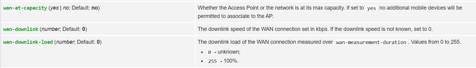

Just wondering … could something be done with “Interworking Profiles” , to inform clients that they are not welcome at a certain busy point in time ?
https://wiki.mikrotik.com/wiki/Manual:Interworking_Profiles
Never tried that one … .
Might need some faking and abusing Hotspot 2.0 features, and needs compatible devices :frowning: .
