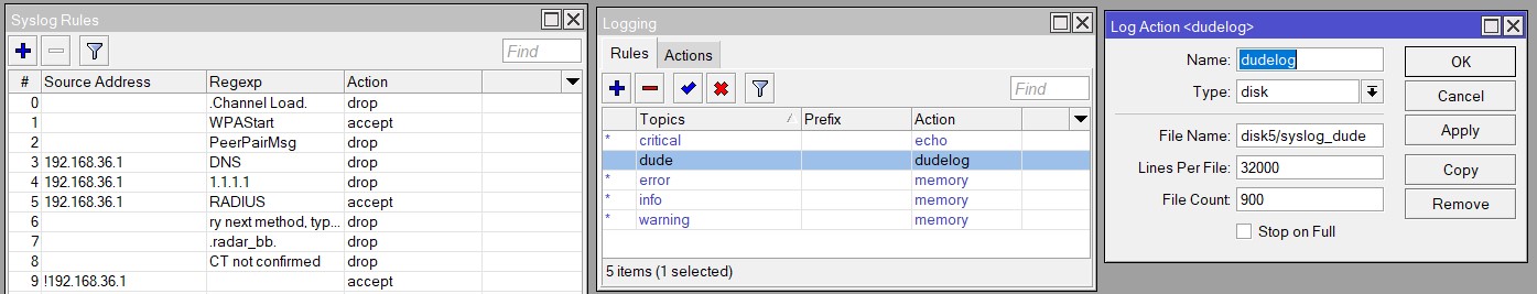

You can increase the line limit per log file, I use 4096 without any problem.
This can be large if you wish …
Sending all important logs to the hEX with DUDE. DUDE has the syslog function built in.
Filtered DUDElog is written to disk via the log system of the hEX
Here external disk, because of volume and many rewrites.
Rolling set of 900 files with 32000 lines each.
32000 limit, as practical limit, because consultation is via files download over 4G connection.
Filtered DUDElog is written to disk via the log system of the hEXHere external disk, because of volume and many rewrites.
32000 limit, as practical limit, because consultation is via files download over 4G connection.Klembord-2.jpg

That’s the second (stronger) option, to send it with “remote” to a SYSLOG like Dude.
Changing logging from action “echo” or “memory” to “disk” would put those logs in the flash file specified, which survives reboots and resets.
You may want to only send some “topics” to flash. All is done in winbox or webfig, no command line needed.
The exemple for DUDE is above http://forum.mikrotik.com/t/is-there-a-way-to-see-all-previous-failed-logins-on-winbox/166239/1 , where “dudelog” action is just some “disk” action in logging for the topic ‘dude’.
(“dudelog” is just using the local logging system to store the received logs (which have topic “dude”) in permanent storage.)
There is no need for syslog function like in dude or the “remote” action to send it, if you just want to store it locally, in flash or USB drive. Just use “disk” as action.
