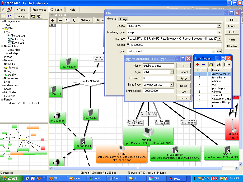

Right Click the link-Go to settings-Type-Click the three dots to the right of the field-Navigate to the link of your choice-Double click and enter the appropriate speed in the Snmp Speed box. If you have many flavors of wifi or a Vlan then click the red plus and make your own link type and adjust it accordingly. NOTE…you MUST check speed and enter the appropriate value in the speed field; this goes for new links or old links. So just setting the link type believing that the color will change as the line becomes saturated is incorrect thinking. Manually set all the speeds so you can see the pretty colors when your pipe gets flooded. I haven’t restarted my dude server, but it won’t set speeds that I adjusted when I created my own links.

I set the speed of a 100Mbps line to 3Mbps(3000000) just to test it and it worked like a champ once I generated the traffic. Holding the arrow over the link will still report 100Mbps, I haven’t figured out how to fix this…maybe you can’t. If you need to know your WAP speeds add a note on each.

I would set the type as fast ethernet AND manually check the speed box and set the speed as 100000000. Dude auto-senses the speed, but if you use traffic shaping or throttling you can go in and change the speed according to the rate that the line actually runs at, not it’s auto-sensed speed. I’ve found that setting the type on links that I edited or created doesn’t work. By the way…in v2.2 the snmp speed seems to be only set on the gigabit ethernet link…don’t know why but it is so.
