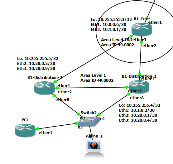

I got this:
Well, both B1-Distribution-1 and B1-Distribution-2 announce 192.168.0.0/24 since one is 192.168.0.2/24 and the other is 192.168.0.3/24 (planning to do VRRP here later).
From my understanding B1-Core should get two LSPs (one from each neighbor) and both of those should have 192.168.0.0/24, so B1-Core should use ECMP to reach the 192.168.0.0/24 subnet. What am I missing, because that's not working.

B1-Distribution-1:
/routing isis instance
add areas=49.0002 disabled=no name=B1 system-id=0255.0255.0004
/routing isis interface-template
add instance=B1 interfaces=lo levels=l1 passive
add instance=B1 interfaces=ether1 levels=l1 ptp
add instance=B1 interfaces=ether2 levels=l1 ptp
add instance=B1 interfaces=ether8 levels=l1 passive
/ip/address/print
Columns: ADDRESS, NETWORK, INTERFACE, VRF
# ADDRESS          NETWORK       INTERFACE  VRF
0 10.1.0.2/30      10.1.0.0      ether1     main
1 10.255.255.4/32  10.255.255.4  lo         main
2 10.20.0.1/30     10.20.0.0     ether2     main
3 192.168.0.2/24   192.168.0.0   ether8     main
B1-Distribution-2:
add areas=49.0002 name=B1 system-id=0255.0255.0005
/ip/address/print
0 10.255.255.5/32  10.255.255.5  lo         main
1 10.20.0.2/30     10.20.0.0     ether2     main
2 10.50.0.2/30     10.50.0.0     ether1     main
3 192.168.0.3/24   192.168.0.0   ether8     main
Does anyone know what am I doing wrong?
