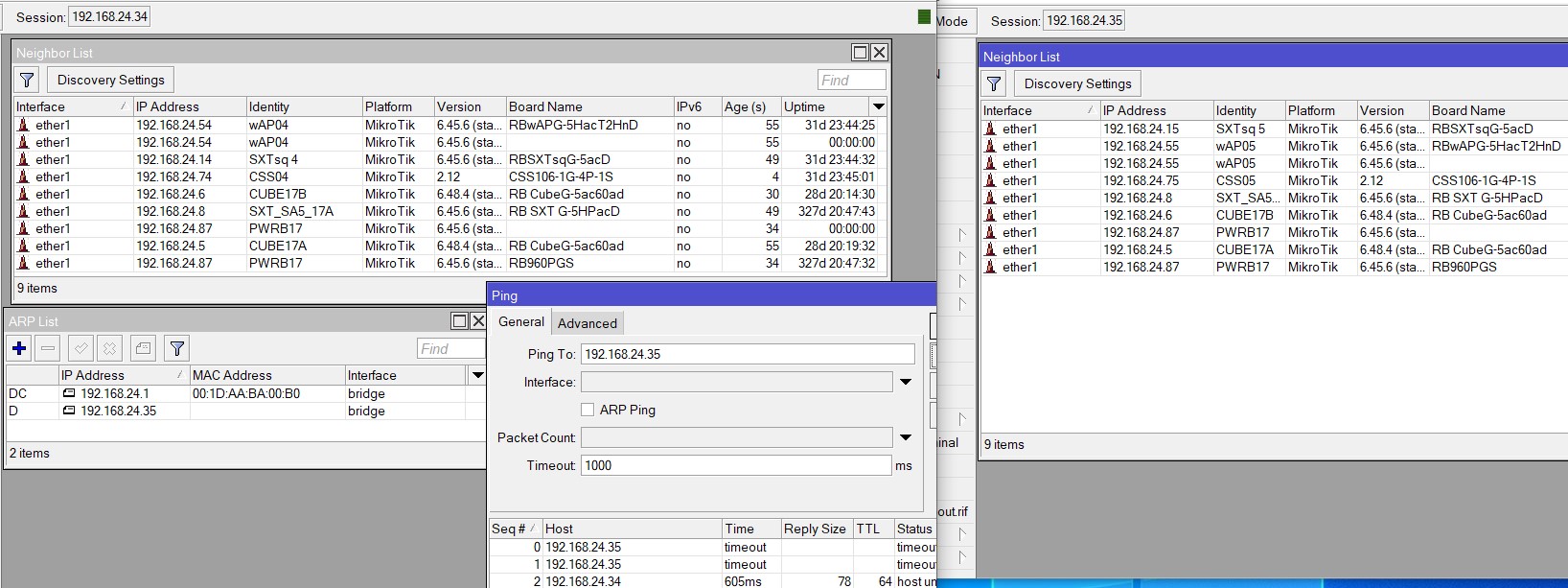

That way I create one big tree shaped network. My tree has following typical long branche, at each knot splitting in 3 subbranches.
Powerbox Pro - PtP CUBE links - Powerbox Pro - SXTSA5 PtoMP SXTsq- CSS106 - APs - SSIDs
Split up is by Horizon - - Horizon - Wifi forward - - - SwOS filter - Horizon - Wifi forward
This stopped Bonjour (iPad looking for printer) and Windows (SMB, NBT) broadcasts from spreading, but also Dropbox, Skype and other softwares that search for neighbors to collaborate.
ROS Neighbors only sees the MT on the branche itself ad subbranches. Btest or PING to another branche is not possible.
Devices are connected to the AP ethernet or SSID, they only have upstream (internet) connectivity. (Unless I make exceptions)
Roaming wifi over the SSID in same or different AP is no problem, and session is not broken.

When did I learn this? Used “VLAN mode = tagged & VLAN ID” on WLAN definition, no bridge VLAN filtering. Works fine.
Then started setting signal strength range to kick off sticky clients off 5 GHz. VLAN usage failed on 5 GHz … (because VLAN mode was not set in the “accept” Access List entry.)
Test would be to make devices go to different VLAN on same WLAN based on client MAC address, by using Access List.
Separation with “horizon” works quite well, as even ARP doesn’t get resolved.
Test from hAP04 (.34) to hAP05 (.35) , sub-branche 4 to sub-branche 5 , common at the SXTSA5
