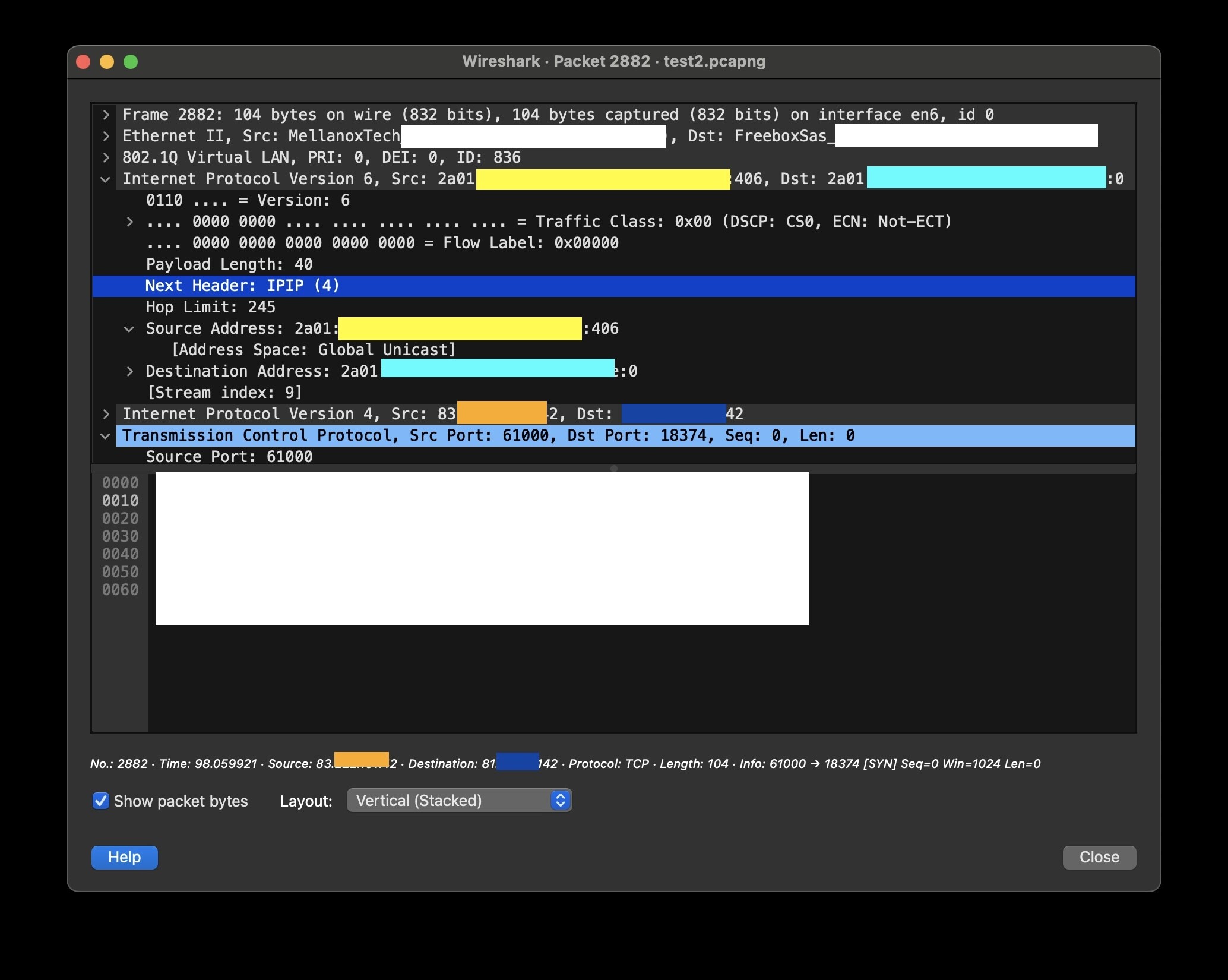

The IPv4 connection provided by Iliad seems to rely on IPv6 encapsulation. For clarity, I intercepted a TCP packet between the ONT and the IliadBox using an hAP ac2 in switch mode with mirroring enabled:

As far as I understand, MAP-E requires IPIPv6 (supported by RouterOS), and since I have access to the full range of ports, I don’t need to configure NAT for port redirection.

+IPv6 of the tunnel (calculated by combining the IPv6-PD, IPv4 in hexadecimal format, and the assigned port range).
+IPv6 of the remote BR (obtained by analyzing an IPv4 packet encapsulated in IPv6).
