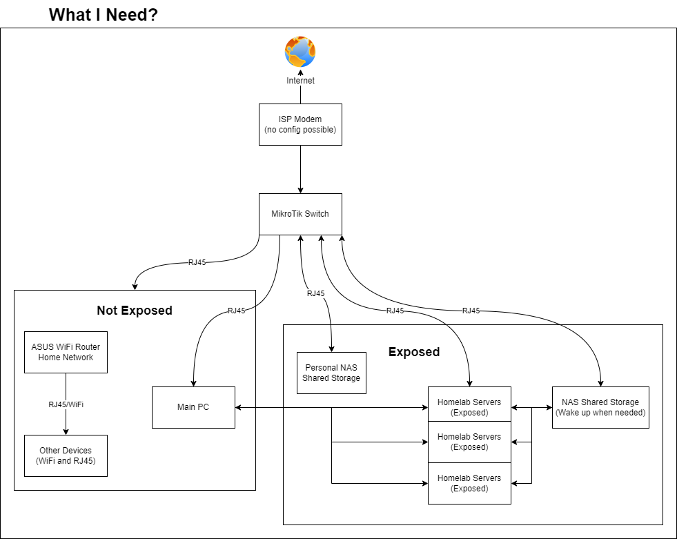

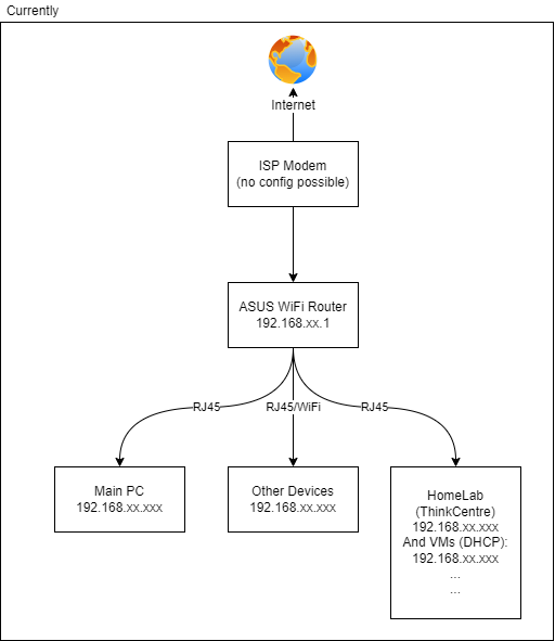

I recently acquired a MikroTik (CRS310-8G+2S+IN); I plan to leverage this hardware to self-host some simple apps with remote access.
The following are diagrams of my current network and the setup I would like to be able to create.
Old Network setup:
Future Network setup:

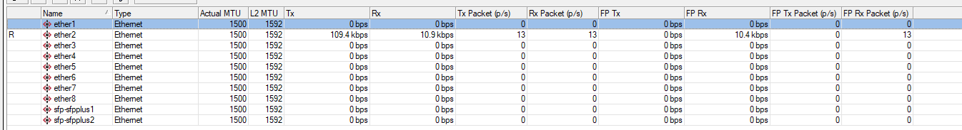

I’d like to see statuses from CLI. Screenshot from the last post by @Kaszanas shows advertised speeds of ether1 … many are useless (anything faster than 2.5Gbps … which is, as per specs, speed of RJ45 ports) and a few are missing (all 100Mbps variants). And I don’t know why those are missing (could be that status window has to be scrolled or that those speeds are really not advertised).
So in essence I’d like to see output of /interface/ethernet/monitor [find name=ether1] which should show something. Also log lines with timestamps around the moment when ethernet cable between ISP router and CRS310 is connected on both ends might show something.
I feel like this could lead to something, could you tell me what would be the command to get all of the required information from the log messages?
e.g. what should be the level of the logs?

20:22:29 system,info device changed by winbox-3.41/mac-msg(winbox):admin@2C:F0:5D:3A:1E:E8 (/interface set ether1 disabl
ed=no l2mtu=1592 mtu=1500 name=ether1; /interface ethernet set [ find ] advertise=10M-baseT-half,10M-baseT-full,100M-base
T-half,100M-baseT-full,1G-baseT-half,1G-baseT-full,1G-baseX,2.5G-baseT,2.5G-baseX,10M-baseT-half arp=enabled arp-timeout=
auto auto-negotiation=yes combo-mode=auto disabled=no fec-mode=off l2mtu=1592 loop-protect=default loop-protect-disable-t
ime=5m loop-protect-send-interval=5s mtu=1500 name=ether1 rx-flow-control=off sfp-rate-select=low tx-flow-control=off; /q
ueue interface set ether1)
