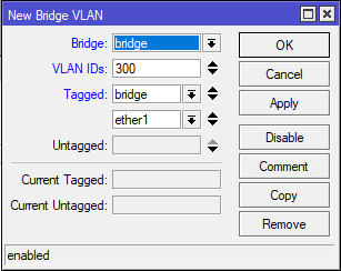

I was thinking creating a VLAN on the bridge which already has DHCP client on it.
Will this work?
It depends on how much your actual setup deviated from default. My suggestion was based on assumption that it’s close enough. For any better advice we have to see config (complete if possible) … open terminal, execute /export file=anynameyouwish (if you’re running ROS v6, add hide-sensitive option), fetch resulting file to your PC, ooen it with favoutite text editor, redact any remaining sensitive data (like serial number or wifi passwords) and post it inside [__code] [/code] environment ( icon in toolbar of post editor).

Looks like a standard config. Just follow the mkx advice. Here are step by step instructions:
  1. Open Interfaces and add a new interface of type VLAN. Name it vlan300 (or vlan-isp, or any name you like), set VLAN ID to 300 and master interface to ether1.
  2. Open IP/DHCP Client and change interface from ether1 to vlan300.
  3. Open Interfaces / Interface List and add a new entry for list WAN with interface vlan300.
  4. Fix an issue in the standard config by changing the interface from ether2 to bridge in the IP/Addresses for 192.168.88.1/24.
