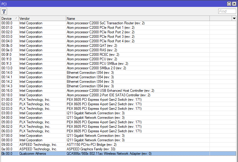

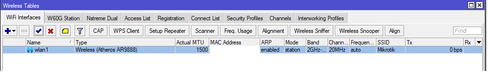

Hello, I just installed RouterOS x86 on a mini PC with an Atheros AR9888 wireless card. Everything works fine except the wireless interface, where the AR9888 is detected but unable to scan and does not show any available Wi-Fi networks. It also doesn’t work as a access point because it can’t broadcast any Wi-Fi SSIDs. I’ve checked the logs, but I don’t see anything that can guide me. I tried to use the wifiwave2 package, but the wireless tables are blank.
