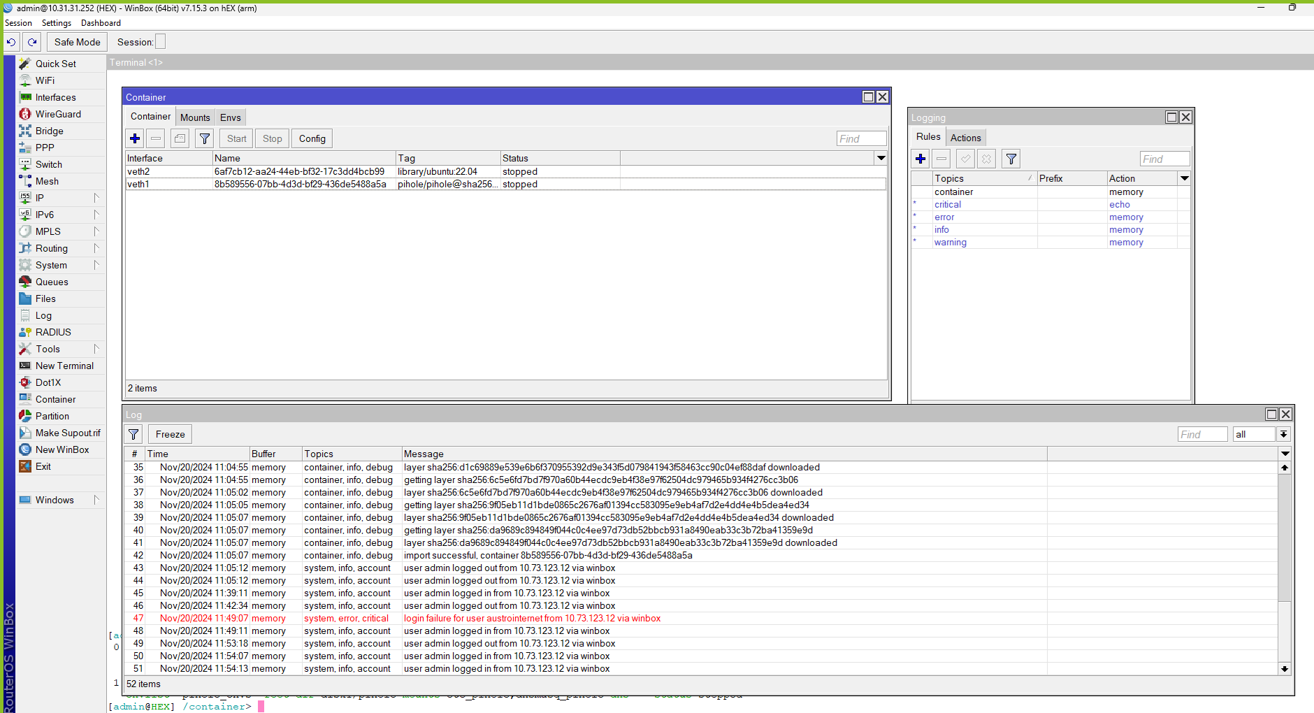

Hello.
I am experiencing an issue where the container is not working on the new HEX refresh (E50UG). I am currently using RouterOS 7.16.1 and Firmware 7.16.1. Additionally, I am utilizing an external USB drive with a capacity of 64 GB for storage purposes.
Are there any known issues related to this that have been reported?
Thank you for your assistance.
Best regards.

Please review the image I have attached.

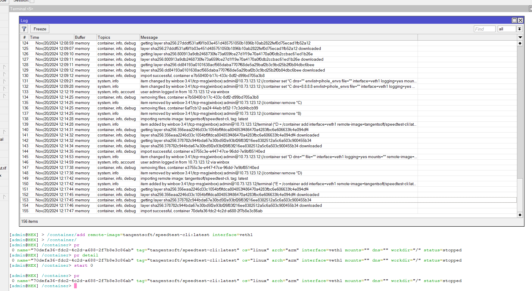

When I click “start” or run the command /container/start 0, it starts but then stops immediately. There is no log generated.
I just imported the container using the following command: /container/add remote-image=tangentsoft/speedtest-cli:latest interface=veth1. https://hub.docker.com/r/tangentsoft/speedtest-cli
The same issue occurs.
[admin@HEX] > /container/add remote-image=tangentsoft/speedtest-cli:latest interface=veth1
[admin@HEX] /container> pr
 0 name="70defa36-fdc2-4c2d-a688-2f7b8e3c86ab" tag="tangentsoft/speedtest-cli:latest" os="linux" arch="arm" interface=veth1 mounts="" dns="" workdir="/" status=stopped
[admin@HEX] /container> pr detail
[admin@HEX] /container> start 0

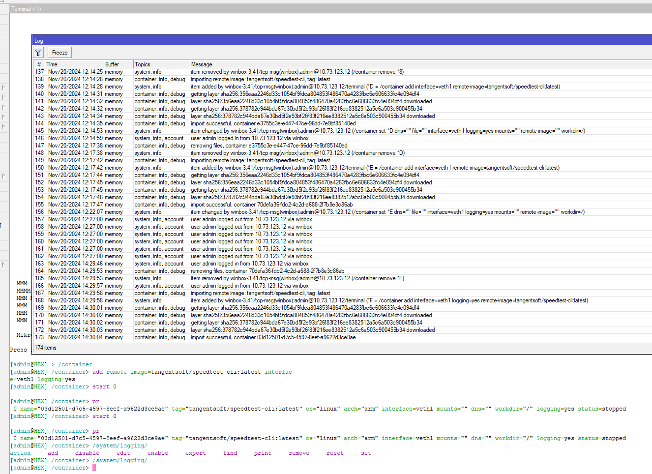

Still not working:
/container add remote-image=tangentsoft/speedtest-cli:latest interface=veth1 logging=yes
/container start 0
[admin@HEX] /system/device-mode> pr
       mode: enterprise
  container: yes
You can see log and commands in image.
I guess is a problem with HEX Refresh (E50UG) itself.
Any advice?

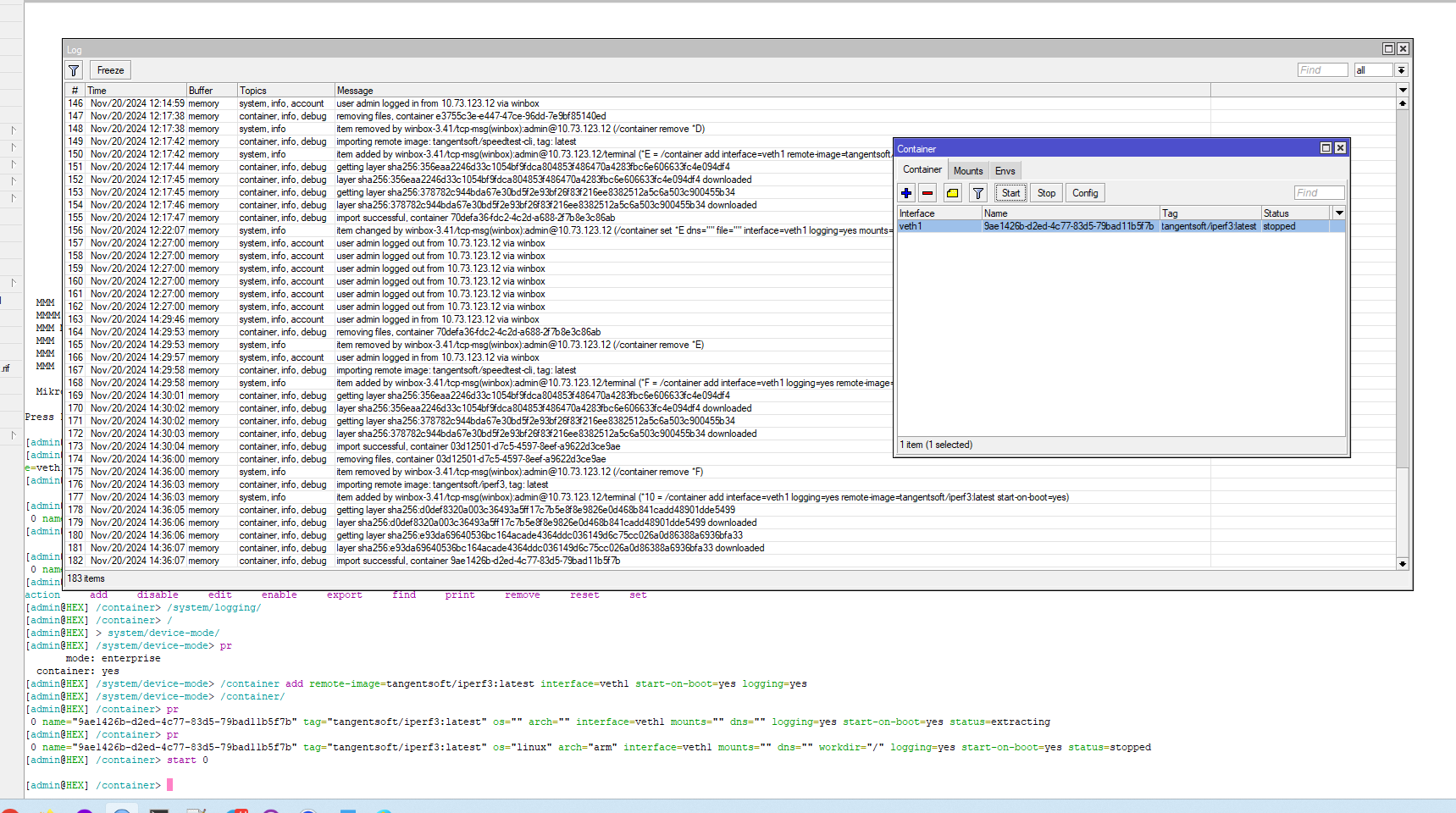

Not working also:
/container add remote-image=tangentsoft/iperf3:latest interface=veth1 start-on-boot=yes logging=yes
start 0
Please check on image

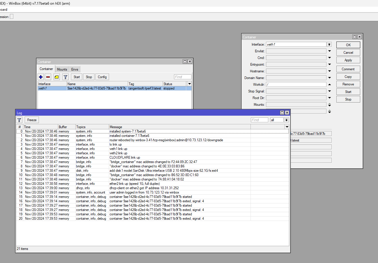

Updated to 7.17beta6 and now there is a log
container 9ae1426b-d2ed-4c77-83d5-79bad11b5f7b exited, signal: 4
same
container df6f9c79-2fac-4cb6-99ed-3de5322e9884 exited, status: 255
