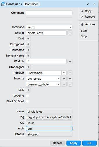

The log file shows this:
container pihole:latest exited, signal: 4 (Illegal instruction) : CPU not supported
The Container-page on the WinBox shows:
Same processor, why would it be different ?
