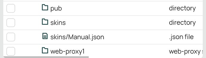

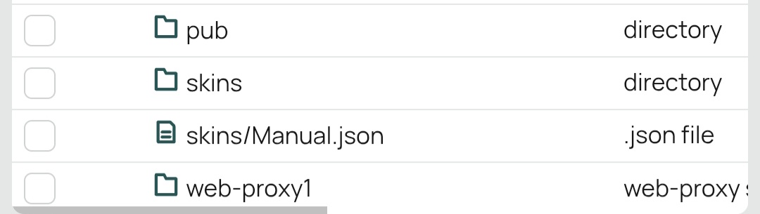

The save confirmation appears, and a file with that name is created in the "skins" folder within the "Files" menu.

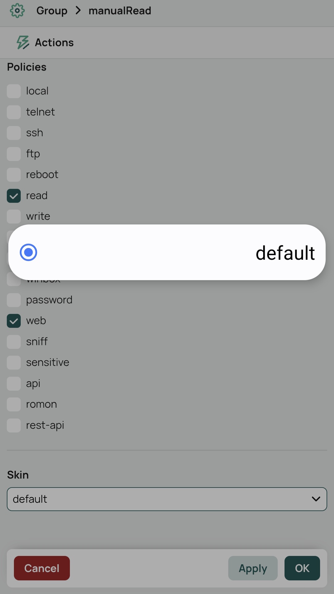

However, when I return to the "Design Skin" menu, only the "default" option is available for selection or editing.
Similarly, in the "System > Users > Groups" menu, only "default" is available as a group skin option.
I read through previous forum discussions where it was suggested to edit the JSON file and replace double quotes (") with single quotes ('). I tried this and re-uploaded the file, but it had no effect.
I even saved the file in the simplest possible format containing just a single line of code (similar to the snippet I’ve provided below) but that didn't work either.
