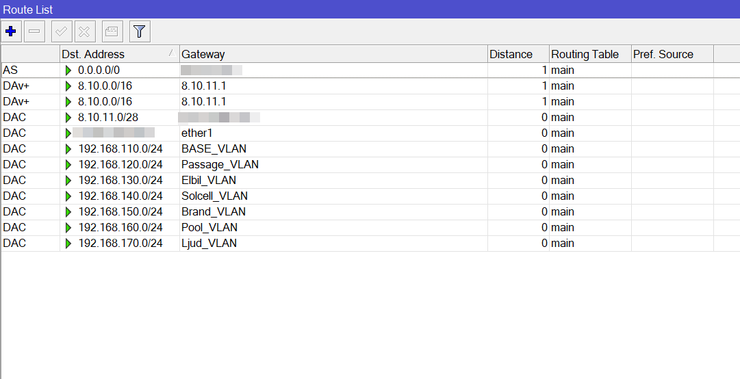

I have attached an image of the routes. I have not created any manually, these where all created by themselves :slight_smile:.

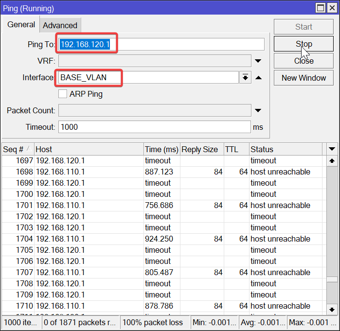

I have also attached an image of what I’m trying to ping. Considering I don’t have access to any of the clients on any of the VLAN’s I can’t ping between them in any way but this ping should work to right?
192.168.120.1 is on Passage_VLAN and I’m trying to ping it from BASE_VLAN and it doesn’t work :frowning:.
