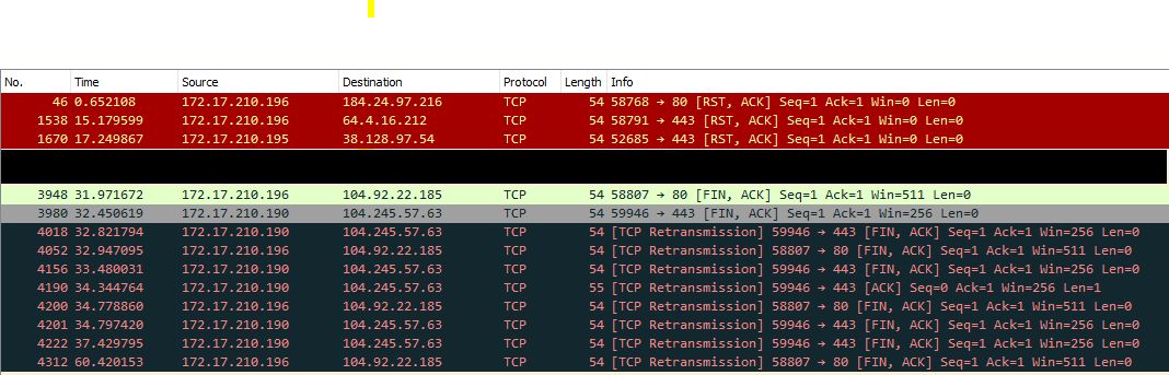

I have a situation in which a Mikrotik router has internal traffic “leaking” to the public interface. Normally this would not be an issue, as most devices upstream would simply pass it on and the packets would be lost somewhere along the way. However, I have issues with cellular networks kicking me off the network momentarily when they see this traffic. It happens when connected via ethernet to a Cradlepoint with a cellular card, or when I have a USB Modem plugged into the USB port of my Mikrotik. We utilize cellular connections as backup internet connections. Even the simplest config has this issue for me:

Taking a packet capture from ether1 shows normal traffic coming from the public IP on ether1. However, there is also random packets showing a source of my internal 172.17.210.x IP address to a public IP. The router in question is an RB2011UAS-2HnD, and it is currently running v6.44.2. I have seen this behavior on at least 6 different RB2011 routers over the last year, resulting in my failover connections not working properly. If I block ALL forward out ether1, I no longer have the issue. I do not know how to block the traffic AFTER the SrcNat, as the forward filter rules take place before SrcNat. Otherwise, I would simply block traffic leaving ether1 with sources from internal.
I am hoping there is a setting somewhere that I am missing that would easily fix this issue. It appears to me that the traffic is skipping the SrcNAT somehow. If anyone has any experience with this issue, I would be greatly appreciative.

I have attached a screenshot of the packet capture. I know it is not super useful, but I would prefer to limit certain information. The screenshot has MAC addresses redacted and a filter on the packet capture to remove the public IP address from view.
