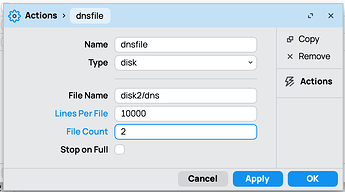

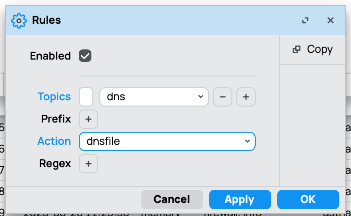

The end goal is to have separate files on disk for the various services (DHCP, DNS, etc.) including some reasonable level of status messaging, and see only critical / error messages when I look at Logs in WinBox.
That’s definitely not happening here, no matter what I’ve tried. As soon as I add the “logDNS” action into the mix WinBox gets spammed with DNS log messages. Even though I think I have explicitly filtered them.
Am I misunderstanding this somehow?

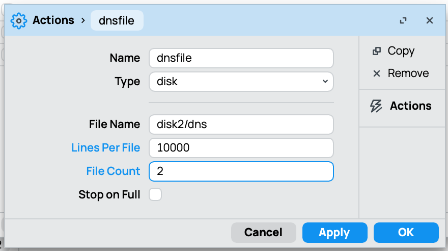

How the topics work is a bit confusing at right. Basically “level” has no specially meaning - topics is more like “tags”, than the syslog-like fields. So levels like “critical” and “debug” are just topics that can be “matched”. There are also “packet” and “raw” that are also level-like things
The 2nd part is there is also the /system/logging/actions… In there you can define a “log destination” to a file. It’s just a destination that you can set based on the “topic matches” to.
Finally, as noted, in winbox the dropdown let you pick which log to see. By default, it “all”. But if you select “memory”, the WinBox looks appear like default.
So if you say topics=dns with a new “action” for it to got a dns log file, you’ll get all levels in file. I would not modify the default. Just add new one each the file-to-topic.
But what I would not do is change the critical and error defaults. If you were working at console, critical message would appear instantly in CLI, which you’d want even with file logging. What you OP photo shows is if there was a “critical” issue with “dns”.

Yeah the selection in top-right corner is the secret to managing it when you have file logging. WinBox “session”/“workspace” remember what you selected there. So if you leave that set to “memory”(or new /system/logging/action like “winbox” where you use topics=!debug,!packet,!raw to go to memory)
Often it’s the packet and raw that get you. Those are topic associated the “debug”, but those often larger protocol dumps – so topics=debug get more than topics=debug,!packet,!raw. Most folk think in terms of linear levels so a “trace” is lower than “debug”, not in RouterOS.
