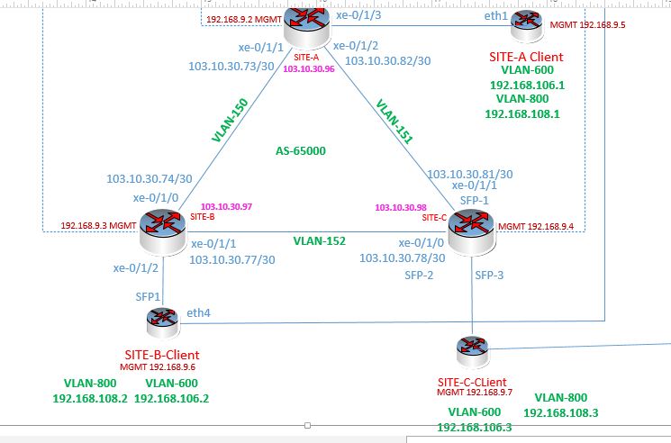

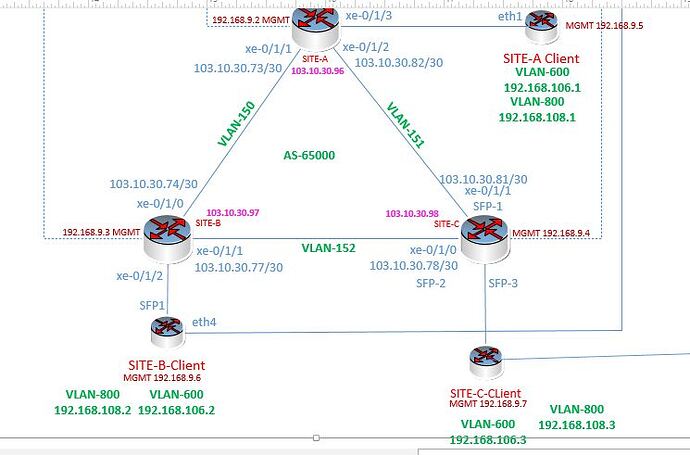

Query:
the BGP/LDP/VPLS/OSPF all protocols are UP and established but still the client_A to client_C can't ping in vlan_800(configured the BGP VPLS).
But within client_A to client_B (both connected to JUniper PE) can ping .
Please help to verify the configuration for establishing the VPLS connectivity between clients.
Any support would be thankfull.

Topology :
client_A(Mikrotik) ----- SITE_A(Juniper)------------------SITE_C(Mikrotik)-----client_C(Mikrotik)

Tested both Martini and Kompella between Jun, cisco and Mikrotik some months ago and it worked fine.
There is a good book on subject :this week mpls from day one and good article on mikrotik wiki.
Dear Vooray,
Thanks for reply.
I would be thankful if u could provide the config script for Kompella and martini VPLS for juniper-mikrotik .
Have you tired setting explicit null?
In the topology you have it looks like the PHP routers would be MikroTik and Juniper. We’ve seen issues before when the PHP routers are different vendors.
Thanks for reply and suggestion .
I tried with enabling the explicit null on mikrotik and juniper for CE connected Node, but still Client could not ping eachother.
Also i can see the both routers could learn the MAC for each client and vice-versa .
What could be the issue ? as both routers learn the MAC .

Dear Mikrotik Support team / Friends,
Please help to provide the solution for configuring the Juniper-Mikrotik LDP/BGP based VPLS .. I had send the below config for analysis .
Dear Friends/Support team.
Currently i faced the issue: Can't ping the mpls ldp lsp from Juniper to Mikrotik Vice-versa, As from Juniper and Mikrotik we could learn the LSP for each path.
Please help to suggest .

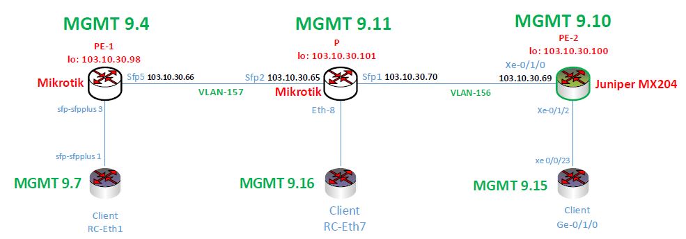

Can you post the output of the MPLS forwarding tables for the Juniper and MIkroTIk routers?
Currently we are not able to ping the point to point mikrotik clients and mikrotik to juniper clients.
Please find the below outputs for Mikrotik and Juniper Routers:

#vianoc@SITE-E-PE2> show vpls mac-table instance vpls1
#MAC flags (S -static MAC, D -dynamic MAC, L -locally learned, C -Control MAC
O -OVSDB MAC, SE -Statistics enabled, NM -Non configured MAC, R -Remote PE MAC, P -Pinned MAC)
#Routing instance : vpls1
Bridging domain : vpls1, VLAN : 600
MAC MAC Logical NH MAC active
address flags interface Index property source
02:04:4f:da:07:3d D lsi.1051649
02:ac:89:60:01:7b D lsi.1051648
4c:5e:0c:14:3b:6f D xe-0/1/2.600
cc:2d:e0:1c:45:59 D lsi.1051649
#[admin@SITE-F-P] > interface vpls print
#Flags: X - disabled, R - running, D - dynamic, B - bgp-signaled, C - cisco-bgp-signaled
0 RDB name="vpls7" mtu=1500 l2mtu=1500 mac-address=02:AC:89:60:01:7B arp=enabled arp-timeout=auto disable-running-check=no
remote-peer=103.10.30.100 cisco-style=no cisco-style-id=0 advertised-l2mtu=1500 pw-type=raw-ethernet use-control-word=no
vpls=BGP_VPLS
1 RDB name="vpls8" mtu=1500 l2mtu=1500 mac-address=02:C9:4C:C9:DE:A9 arp=enabled arp-timeout=auto disable-running-check=no
remote-peer=103.10.30.98 cisco-style=no cisco-style-id=0 advertised-l2mtu=1500 pw-type=raw-ethernet use-control-word=no
vpls=BGP_VPLS
#[admin@SITE-F-P] > interface bridge host print
#Flags: L - local, E - external-fdb
BRIDGE MAC-ADDRESS ON-INTERFACE AGE
vpn 02:04:4F:DA:07:3D vpls8 5s
#L vpn 02:AC:89:60:01:7B vpls7 0s
#L vpn 02:C9:4C:C9:DE:A9 vpls8 0s
vpn 4C:5E:0C:14:3B:6F vpls7 35s
#L vpn 4C:5E:0C:C9:13:19 vlan-600 0s
vpn CC:2D:E0:1C:45:59 vpls8 59s
Have tried configuring same scenario and issue is same. LDP is exchanging labels but unable to reach P2P between client A and and client B. Have you found any possible solution for this?
I have not tried to replicate this exact issue, but I did publish an article a few months ago about Juniper to MIkroTik MPLS with VPNv4 which works well.
You can at least use it to verify MPLS between MikroTIk and Juniper.
https://stubarea51.net/2020/01/22/juniper-to-mikrotik-mpls-and-vpnv4-interop/
