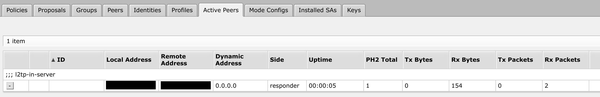

The new files are in. Here’s what I got from /ipsec policy print:
 0 T  * group=default src-address=::/0 dst-address=::/0 protocol=all
        proposal=default template=yes
 1   DA  peer=l2tp-in-server tunnel=no src-address=***MikRouter***/32
        src-port=1701 dst-address=***Phone***/32 dst-port=any protocol=udp
        action=encrypt level=unique ipsec-protocols=esp proposal=default
        ph2-count=1
ipsec-start-second-try.txt (67.2 KB)
console-dump.txt (3.07 KB)
