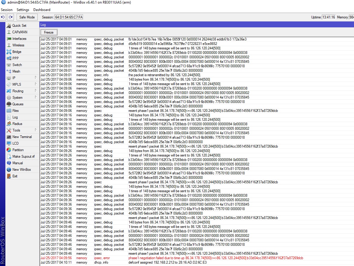

I have created on my new main firm router RB3011UiAS a VPN connection L2TP/IPSEC.
It is strange because if I connect with my cell phone (with win8.1 -pls. don’t laugh) the connection works with no problem, I can enter on network, connect to my devices… and is dam fast compering with may old router…
Unfortunately, when I try to connect from my home with my comp (WIN10) I get error on connection.
I try to find the answer looking for some clues and I find this: if I turn off the VPN pass thru, reboot and re-activate VPN pass thru on my personal router (WDR4300) the connection works. I have change the personal router software with DD-WRT and I need to do the same procedure for connecting by VPN.
With my old main firm router the VPN connection worked with no problem…
I will attach a print screen with logs.
Thank you.

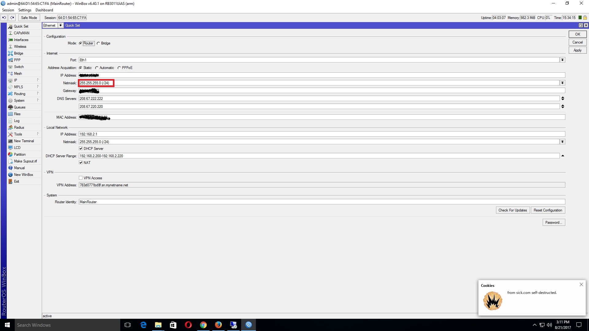

At last, I found a solution:
First, I had some sites that I could not access. With traceroute Ip’s ware bloked on router ip address …
I have changed the netmask on “Internet” settings from 255.0.0.0/8 to 255.255.255.0/24.
Now everything works …
