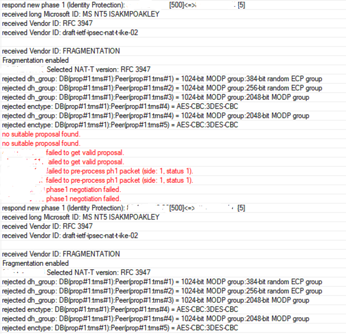

I have setting up L2TP IPSec tunel (client-server type).
connecting form windows 10 PC. L2TP server , prifile, secret, settings I believe are ok.
Then i try to connect im getting error no good proposal found phase1 failing.
I did debug see attached picture.
Can someone explain what is wrong by the debug log, as as much i have tried various settings on the peer and proposal all the time getting the same on debug log.
your help is much appreciated

Well, you haven’t pasted the log, but let’s try without if first.
The first issue is that you have two peers with (remote) address=0.0.0.0/0, the one for L2TP and another one for IKEv2. I’m not sure whether the fact that the L2TP one is declared first is sufficient to let incoming connections be matched to this peer. So as the first thing to try, disable the IKE2 one to be sure that it does not shadow the L2TP one. If it doesn’t, then the L2TP one shadows the IKE2 one. It’s simply not possible to have two IPsec peers open for 0.0.0.0/0 unless you bind them to different local addresses (which may not be possible if you only have a single public address) - the peer to use is only chosen up to the combination of local and remote address of the initial packet, not by any information carried inside the packet.
Next, you don’t use the automatically (dynamically) created IPsec peer for L2TP/IPsec; instead, you have created one manually. I can see that the peer (phase1) proposal only permits 3des encryption-algorithm; I’m not sure whether the Win10 client supports it too. So first try to permit all encryption-algorithms in the peer proposal; if that way the Phase 1 establishes, you can proceed by tuning the policy (Phase 2) proposal. Some more points are that
  • in the automatically generated peer, passive is set to yes, which is not the case on your manually created peer (this affects Phase 1)
  • proposal-check is set to strict while yours is obey (I’m not sure whether this affects Phase 1)
  • generate-policy is set to port-strict while yours is port-override

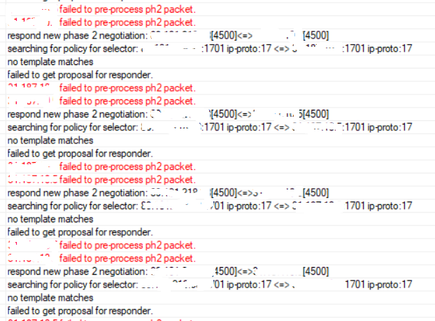

/log print where topics~“ipsec” is much more useful than screenshots.
The log says
searching for policy for selector x.x.x.x:1701 ip proto:17 <=> y.y.y.y:1701 ip proto:17
no template matches
So it points back to what I’ve written before:
Your configuration export shows that you have disabled the default policy template:
/ip ipsec policy
set 0 disabled=yes
So you have to re-enable this default /ip ipsec policy template and make sure that its group property is set to default. Next, you can either let it this template point to the proposal named “default”, or you can create another proposal and let the default policy template point to it, e.g. /ip ipsec policy set 0 proposal=L2TPVPN
very strange as default proposal in not disabled its enabled next the command to change default proposal as default L2TPVPN didnt works , default is still default and i have full rights on mikrotik
ok my mistake didnt get you right have enabled default policy pointed to L2TPVPN proposal , ok now im not getting any errors but connection is not established, no errors on mikrotik but windows keeps connecting until fails.
Yes, there is a lot of “default” items and a complex structure of references/dependencies in the IPsec configuration. It needs some experience to realize all the relationships.
