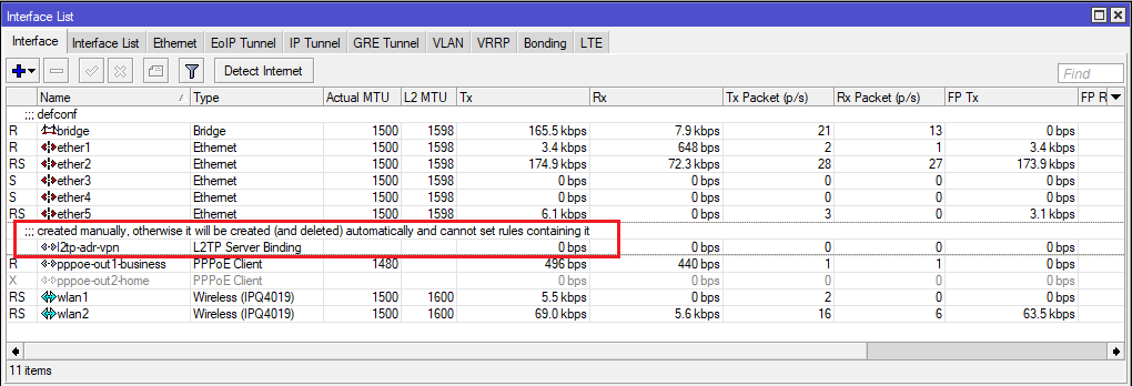

  • I added an interface in interface list, I noticed if I don’t it would be created on-the-fly.

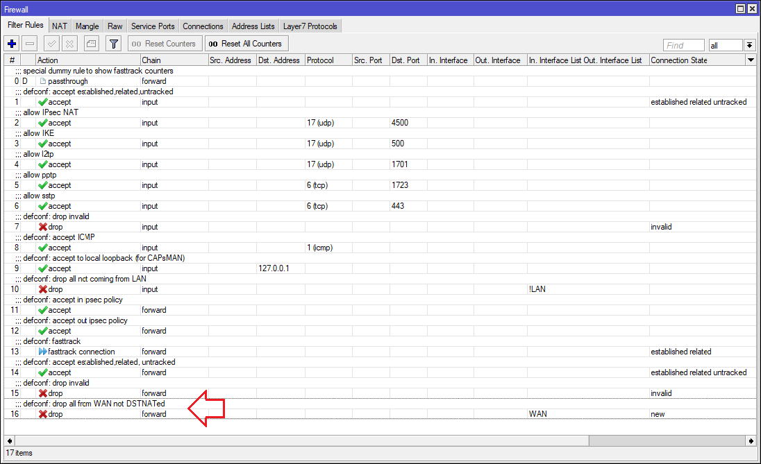

  • the VPN client (iPhone) connects OK but cannot get internet access unless I disable that last firewall rule (drop all from WAN not DSTNATed).

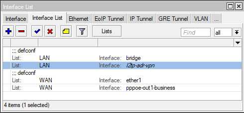

  • it also gets internet access if in “interface list” I remove the L2TP interface from the “WAN” group, but it gets added back when I reconnect.
  • it also gets internet access if I add to that highlighted firewall rule: “interface NOT my L2TP interface”, but not sure if this is the solution or just lower security.

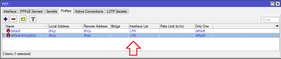

  • I tried setting interface list to “LAN” inside the PPP profiles, but it didn’t seem to do anything.

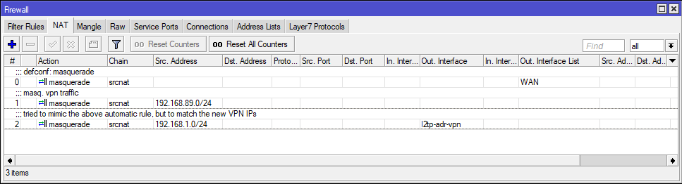

  • Inside the NAT rules, I added that rule, trying to mimic the one above it (that was added automatically), maybe that is the right solution but I did something wrong there ?

Change in PPP profiles → Inrfacelist to LAN

  • If you have “drop all from WAN not DSTNATed” rule, then adding L2TP interface to WAN list is bad idea, because it will block all traffic from VPN client, except if you’d connect to some forwarded port, but you don’t have any. Either add it to LAN list or you can keep it separate.
  • It seems you’re using “detect internet” and it’s adding L2TP interface to WAN list. Do you really need it?

  • It’s not clear if you need NAT rule #1 and you shouldn’t need #2.

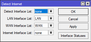

  • disable detect internet, I am not sure I did it right, “detect interface list: none”, “internet interface list: none” (?).
  • then added the vpn interface to “LAN” only.

I’d do some things differently, but I don’t see anything obviously wrong. There’s nothing that would break VPN connections after you disabled ‘detect internet’, you accept its traffic unconditionally. Routing from VPN to internet is not blocked by any rule either.

But the “detect internet” disabling above looks OK in the small image ?

If you want to experiment, then instead of default-allow firewall with rules like:
add action=drop chain=forward comment="defconf: drop all from WAN not DSTNATed" connection-nat-state=!dstnat connection-state=new in-interface=!l2tp-adr-vpn in-interface-list=WAN
that may not be very easy to read and understand, you can try default-block firewall, where the basic idea is to allow selected stuff and block everything else. Not that the first one would be wrong, but I find this easier to get right. E.g. (assumes L2TP interface in interface list name VPN):
add chain=forward connection-state=established,related,untracked action=accept
add chain=forward connection-state=invalid action=drop
add chain=forward connection-nat-state=dstnat action=accept comment="allow forwarded ports"
add chain=forward in-interface-list=LAN out-interface-list=WAN action=accept comment="allow access from LAN to internet"
add chain=forward in-interface-list=VPN out-interface-list=WAN action=accept comment="allow access from VPN to internet"
add chain=forward in-interface-list=VPN out-interface-list=LAN action=accept comment="allow access from VPN to LAN"
add chain=forward action=log log-prefix="will-be-blocked" disabled=yes comment="enable this to see what is blocked"
add chain=forward action=reject reject-with=icmp-admin-prohibited
Just simple and easy to understand rules. If you forget to allow something by mistake, you’ll notice immediatelly, because it will be blocked. And if you are not too careless, you can’t incidentally allow something (which if you would is kind of mistake that can be harder to notice).

So with the above recommended rules, I add my L2TP interface to a “VPN” interface list, and do I also set this list name under the “PPP > Profiles > Interface list” ? Or can I leave that blank ?
And for L2TP with Ipsec, do I only need 1723 and can I disable 443,500,1701,4500 ? (I think router created these when I enabled VPN under quick set).
I don’t use it often and I’m lazy to test it now, but it should be enough to use only one, either add interface to interface list manually, or let it happen automatically using the config in PPP profile.

So if I add my L2TP interface both inside “Interfaces > interface lists” (e.g under LAN) and I also specify “LAN” under interface list of “PPP > profiles”, then it disconnects me when I try to connect.
I under if this is a bug. Basically it refuses the connection when PPP profile tries to add the L2TP interface to a list that already has the interface.
Otherwise it works OK if I only specify interface list in one of the above locations.
