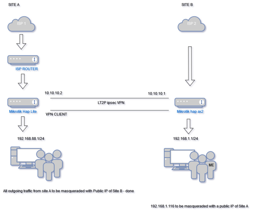

Hi all,
I have a question regarding an L2TP site-to-site VPN.
Site A:
Mikrotik hap lite
Private IP: 192.168.88.1
Site B:
Mikrotik hap ax2
Private IP: 192.168.1.1
These two routers are in different countries. I have set up an L2TP site-to-site VPN, and any device connected to the router at Site A that tries to access the internet is masqueraded with the public IP of Site B. This part is working fine.
However, I am now trying to achieve the following:
I want only one specific IP address at Site B (192.168.1.116) to be masqueraded with the public IP of Site A.
Could someone advise on the best way to achieve this?

Thank you for your response, and apologies if my explanation is not the best. I attached a little diagram of my network as I believe it might help to understand what I am trying to achieve.
