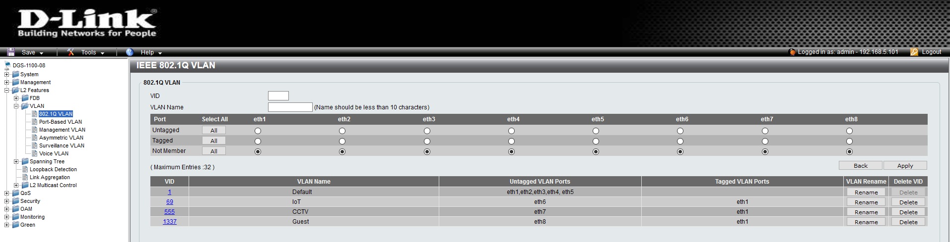

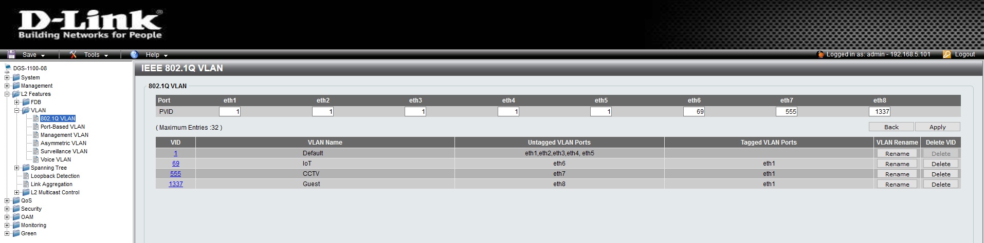

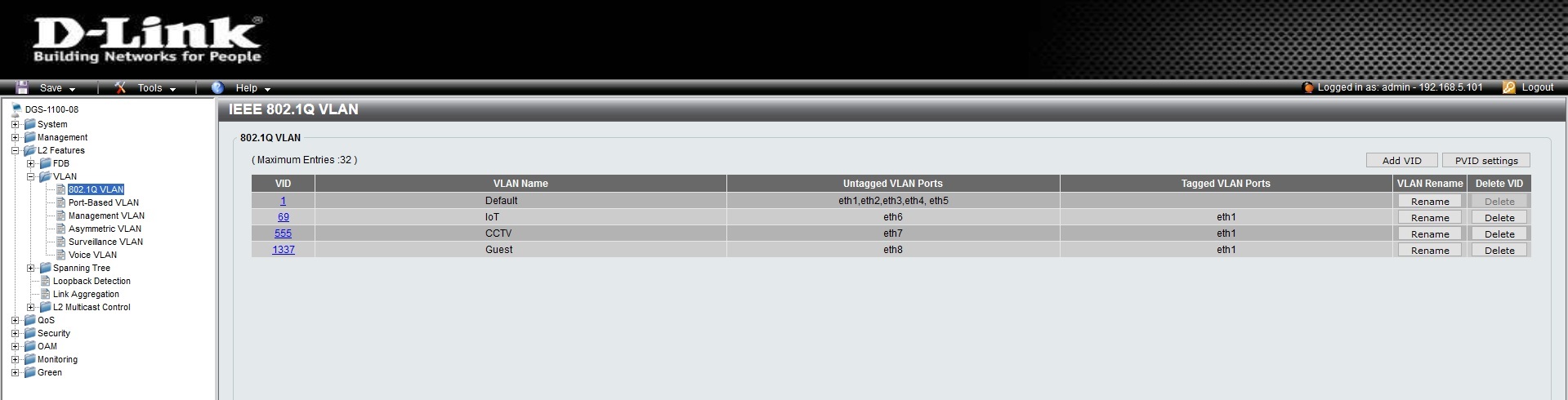

Dlink smart switch:
vid=1, untagged ports=eth1,eth2,eth3,eth4,eth5 / tagged ports=none
vid=69, untagged ports=eth6 / tagged ports=eth1
vid=555, untagged ports=eth7 / tagged ports=eth1
vid=1337, untagged ports=eth8 / tagged ports=eth1
pvid=1(eth1,eth2,eth3,eth4,eth5), pvid=69(eth6), pvid=555(eth7), pvid=1337(eth8)
I have 2 issues.
1)When I transfer data between devices connected to the switch at default vlan ports (2 to 5, because port1 go to the router), they got 192.168.5.0/24 addresses and also got almost 1Gbps rate, ok, no problem so far.
But if I connect some device to the router at ether4 or ether5 port, it gets 192.168.5.0/24 address, and transfer data to any device connected to the switch at defeault vlan port, then only got 10Mbps rate instead of 1Gbps. Besides, when connected 2 devices to the router at ports ether4 and ether5, they got 192.168.5.0/24 addresses but also got 10Mbps. What I did wrong?
2)If I change at the switch, port1 to tagged, every device connected to default vlan ports still get 192.168.5.0/24 address but cannot connect to the router. How can I solved it?
port eth1 at switch “should be a trunk port”, but I understand that trunk port must be tagged on all vlans.
Thanks a lot for your comments :wink:
Post configuration export of your RB (execute /export hide-sensitive file=anynameyouwish in terminal window, fetch resulting file, open it with text editor and copy-paste conrents inside [__code] [/code] environment).
As to trunk config: usage of VLAN ID 1 is highly discouraged. That VID is implicit default value everywhere and it’s very hard to change dedaulrs so that use of VID 1 is trouble free. OTOH when talking about untagged "V"LAN between RB and Dlink, it doesn’t have to be the same VID used on both devices, packets are exchanged tagless between them (in case you want to stick to VID 1 on Dlink for some reason). I’d suggest to use all-tagged conection between both LAN gadgets anyway.

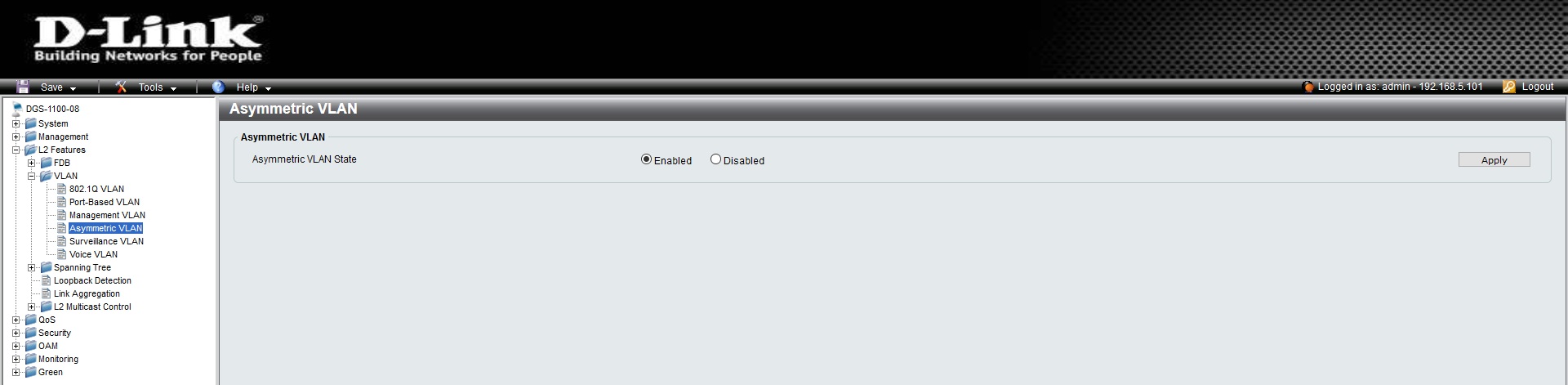

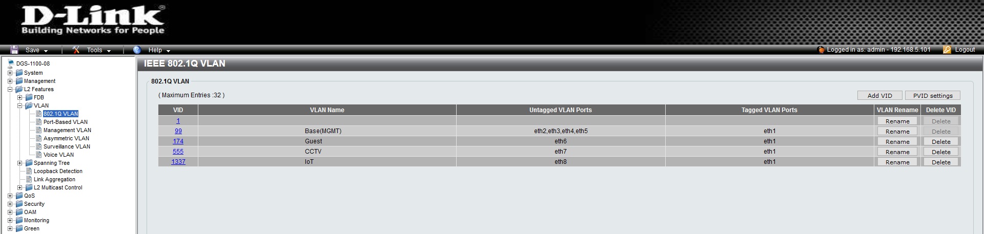

Here are the pics…
Interesting your DLINK is different from mine but I think I see where.
IN the VLAN menu I have a separate selection and the order is put in all the necessary VLAN-IDS in the 802.1q menu entry.
This seems the same for both switches.
When one enters a new VLANID here, it automatically enters in that VLANID in every trunk port that is already assigned, so one has to then remove that vlanID from all trunk ports where that vlan is ntor required. The actual assignments of ports etc, is not done in 802.1q the meat of the work, but is done in my menu selection of VLAN INTERFACE.
I will post my config in pics next. Before I do that I believe that the settings for something similar are ON YOUR 802.1Q page, in the upper RIGHT where it said VID and PVID.
I dont have those. So I will ask you to post a picture of each one of those selections.

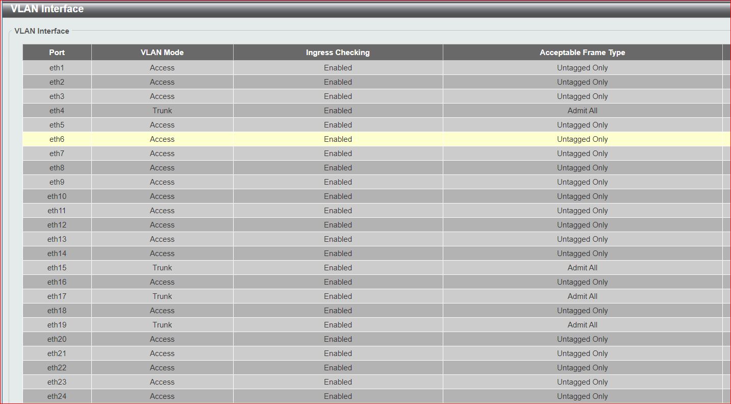

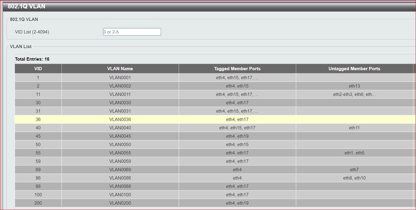

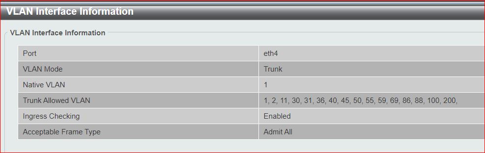

So here are my pics which show my 802.1q selection, my VLAN Interface page, and then I will show a TRUNK Port assignment (ether4) and an access port assignment ether3.
Pay close attention to ether4, the trunk port and ether3 an access port.
In your case eth4 is a trunk port which means will be tagged on all vlans, however eth3 is an access port which means untagged.
In my case… I dont have trunk nor access port… just tagged, untagged and not member.

Add VID
PVID Settings
Yup pretty much as expected.
For the second pic…
All trunk ports should be left with the default pVID of 1, all access ports require the pVID of the vlan that port tags traffic coming in and untags traffic going out.
On the top pic, that is where one assigns the tagged or untagged ports.
So pick a vlan, there are two possibilities and you apply that vlan across the available port…
if its an access port for that vlan then assign it as untagged to that port.
if its a trunk port that is supposed to hold that vlan then assign it as a tagged port.
Note
  • only only one vlan can be assigned to an access port (untagged)
  • multiple vlans can be assigned to a trunk port (tagged)
  • a hybrid port if required is possible but only one vlan (untagged) as per the first rule can be assigned to a hybrid port the rest half to be one or more tagged vlans.

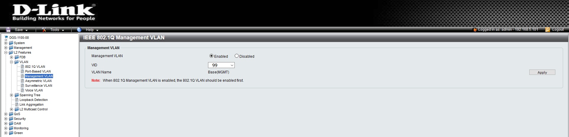

Now on the MT router you have decided what is your management vlan.
It can be the home (trusted) vlan or a separate vlan. Whatever is decided that is the subnet that all managed devices such as switches should get an IP from.
So ensure you setup the Ip address of the switch appropriately, I normally static assign it outside the IP pool.
I suppose you can then find the management vlan entry for the DLINK and put in the appropriate vlan ID.
I noted I have done that on my TPLINK switch but for some reason didnt do it on my DLINK.
Unable to change it now as other users are on, but will endeavour to activate that setting as curious to see if it makes any difference, havent needed it thus far LOL.

I use the words trunk port to state the purpose of the port, to carry vlans that are tagged and heading towards or from other smart devices that can read tags
I use the word access port to state the purpose of the port which is to carry data to devices that cannot read tags, and therefore on that port the switch tags data coming from the dumb device and then untags the data before sending back to the dumb device.
There is no difference from what you are doing than anybody else. Since MT tends to talk in the vernacular of trunk and access port its simply time to learn what that means…
