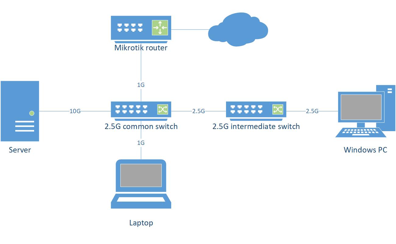

I have two devices, a client PC and a server, connected through a 2.5Gbit switch that sits behind the router I just set up.

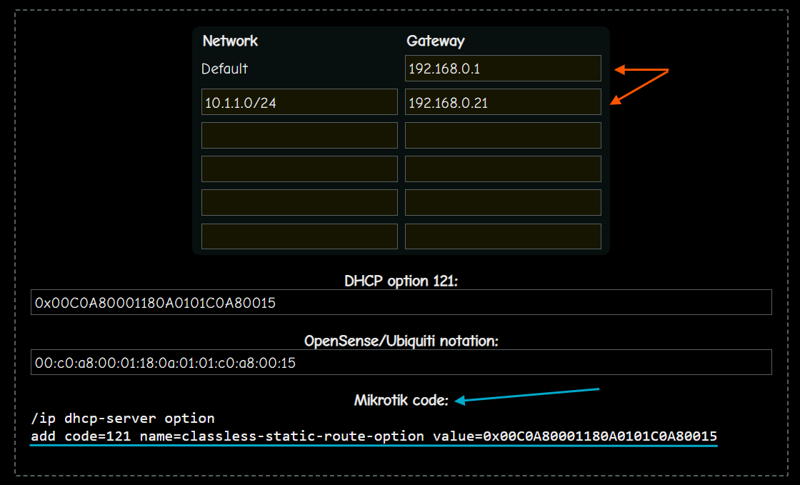

add action=accept chain=input comment=
"defconf: accept established,related,untracked" connection-state=
add action=drop chain=input comment="defconf: drop invalid" connection-state=
invalid
add action=drop chain=input comment="defconf: drop all not coming from LAN"
in-interface-list=!LAN
add action=accept chain=forward comment="defconf: accept in ipsec policy"
ipsec-policy=in,ipsec
add action=accept chain=forward comment="defconf: accept out ipsec policy"
ipsec-policy=out,ipsec
add action=fasttrack-connection chain=forward comment="defconf: fasttrack"
"defconf: accept established,related, untracked" connection-state=
add action=drop chain=forward comment="defconf: drop invalid" connection-state=
invalid
add action=drop chain=forward comment="defconf: drop all from WAN not DSTNATed"
connection-nat-state=!dstnat connection-state=new in-interface-list=WAN
add action=masquerade chain=srcnat comment="defconf: masquerade" ipsec-policy=
out,none out-interface-list=WAN
add comment=VMs disabled=no distance=1 dst-address=10.1.1.0/24 gateway=
192.168.0.21 routing-table=main scope=30 suppress-hw-offload=no
target-scope=10
add comment=VPN disabled=no dst-address=10.8.0.0/24 gateway=192.186.0.21
routing-table=main suppress-hw-offload=no

No connections to other local IPs go through the router as pc<->laptop gets full gigabit, and connections to other devices that host management pages are instant while even the simplest page on the server takes seconds to start communicating. It was fully switched before I changed the router even with VPN on as the speeds were 2.5Gbps while the router only had 1Gbit ports
Just for reference the devices I tried speeds with are connected like this, over the same switch going to laptop always works while the server IPs go through router

The 10.1.1.0/24 is set up as a static route on the router to 192.186.0.21.
@CGGXANNX Changing the Syn Sent Timeout "fixes" it, could it be because the server is ultimately responding out of the 192.186.0.21 interface so the traffic is just switched and bypasses the router on the return path like what you said for the original issue? If that is the case what would be the correct fix - disabling connection tracking on the 10.1.1.0/24 range?
First is from VM, second is from the VM host
root@jellyfin:~# ip route
default via 10.1.1.1 dev enp5s0 proto dhcp src 10.1.1.15 metric 100
10.1.1.0/24 dev enp5s0 proto kernel scope link src 10.1.1.15 metric 100
10.1.1.1 dev enp5s0 proto dhcp scope link src 10.1.1.15 metric 100
root@jellyfin:~#
exit
numerlor@serv:~$ ip route
default via 192.168.0.1 dev enp104s0f0 onlink
10.1.1.0/24 dev incusbr0 proto kernel scope link src 10.1.1.1
10.8.0.0/24 dev tun0 proto kernel scope link src 10.8.0.1
192.168.0.0/24 dev enp104s0f0 proto kernel scope link src 192.168.0.21
192.168.0.0/24 dev enp104s0f1 proto kernel scope link src 192.168.0.20 linkdown
numerlor@serv:~$
The server always returns the packet "on-link", because the destinations of the response packets are all in the 192.168.0.0/24 range, which for it don't need the router to be involved.
But the client devices when sending packets towards 10.1.1.0/24 all send through the MikroTik hEX S (2025) router, unless they have a route telling them to use 192.168.0.21 as gateway for those range. For Windows I've added the command in the above post:
The delay is caused by the router waiting for the SYN,ACK response to the initial SYN packet, before forwarding more packets of the connection (in the direction client -> server, the router doesn't see any of the packets in the server -> client direction at all). Because the router never sees those SYN,ACK response, it has to wait for the timeout.

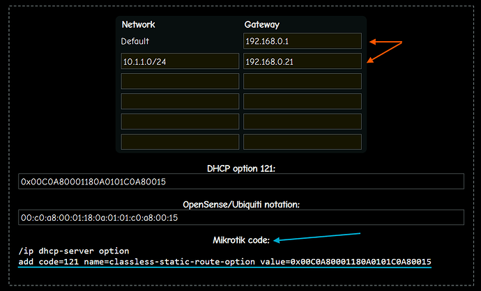

But I don't think it's wise to reduce that delay. What you can do for the devices that don't allow manual route adjustments, like your TV, is to use DHCP to announce the extra routes using DHCP Option 121. Here is an example on MikroTik documentation:
But it's probably better to use a tool like this one to generate the option string for you:
Configuring Classless Static Route Option · Medo's Home Page
For example, to generate the route list for your case, as seen in the screenshot, you need to create this Option 121 entry:
/ip dhcp-server option
add code=121 name=classless-static-route-option value=0x00C0A80001180A0101C0A80015
This option can then be set on the individual leases, or add to the IP -> DHCP Server -> Networks entry corresponding to the subnet. Once the clients renew their addresses (or if forced by you), if they support DHCP Option 121, then they will also have the destination=10.1.1.0/24 gateway=192.168.0.21 route installed.
