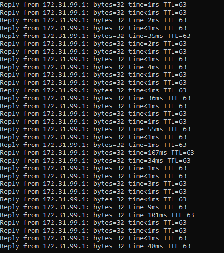

I’ve got a hAP AC Lite acting as an AP for my home. I recently moved my computer and connected it to a wAP in station mode as a means to connect wirelessly. I have strange spikes in latency and I haven’t been able to figure it out. There is clear line of sight between the 2 AP’s, distance is around 6 meters. The spikes will be anything from 30-1000ms. It doesn’t last long but it’s enough to ruin online gaming.

Please see attached. 172.31.99.1 is the hAP. Throughput is also quite low, I’ve got a 100mbps link but only getting around 20 down and 40 up. But that’s not the biggest concern, the concern is around latency spikes. I have around 5-6 devices connected at any one time.

It’s ruining online gaming completely. Every one of those spikes cause huge lag for 1-2 seconds. Are we saying that as long as you run 2.4GHz you won’t be able to play online games?
I’ve tried that. Currently have both antennas set to 2427 to try and mitigate the problem. Is that the correct way of doing it? Or should I set the hAP to a frequency and the WAP to another?
