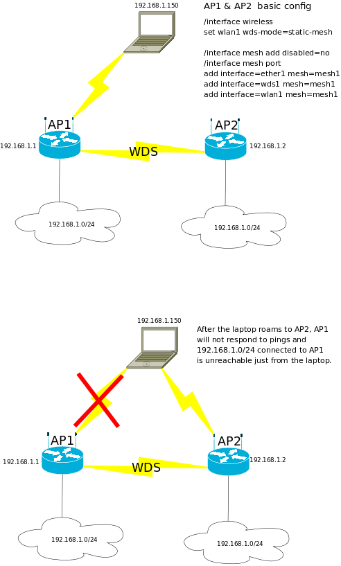

I’m having a strange Layer-2 Mesh problem. I have two APs connecting to each other using dynamic-mesh wds-mode. I’ll call one AP R1 and the other R2. On R1 I have two interfaces, wlan2-mesh, and wds1. On R2 I have three interfaces,ether1, wds1, and wlan1. On both routers I put those interfaces into a mesh named mesh-bridge. R1 is assigned 192.168.3.1, and R2 is assigned 192.168.3.150. If I connect my laptop to R1 and the roam/transfer to R2, then R1 stops responding to pings. The opposite happens if I connect to R2 and roam to R1. I deleted the mesh interface and setup a rtsp bridge with the same ports and everything works correctly with both APs responding even when I roam. What could I possibly be doing wrong?

Network diagram.

This thread is almost 5 months old… The bug was squashed in v3.15.
