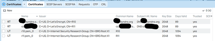

I’m working now at an environment that has an MT devices connected directly to the Internet (no UDM or other router).
I uploaded and imported the intermediate CA certificates and it looks like this.
I previously watched a video and there was no mention of needing an intermediate CA cert.
Is this correct now?

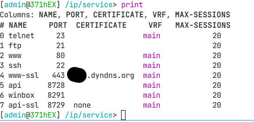

Looks fine to me. I have never tried to request two certificates for the same machine, what does /ip/service/print detail where name=www-ssl show?
It depends on a lot of factors. The background is that the “recipient” of the certificate needs to be able to walk through the complete chain of trust starting from the own certificate of the “sender” through all the eventual intermediate CA certificates up to the root CA certificate. The whole idea of the chain of trust is based on having the root CA certificate pre-installed in the certificate store of the recipient; the intermediate certificates may be pre-installed there as well or the sender of the certificate may send them together with its own certificate. ISRG started using R10 and R11 to sign certificates issued since June or July this year, so it is possible that the previously used intermediate CA certificates were pre-distributed as part of operating system updates so the author of the video you refer to did not have to make them available to the certificate sender for addition to the initial TLS exchange.
Looks like only 1 certificate:

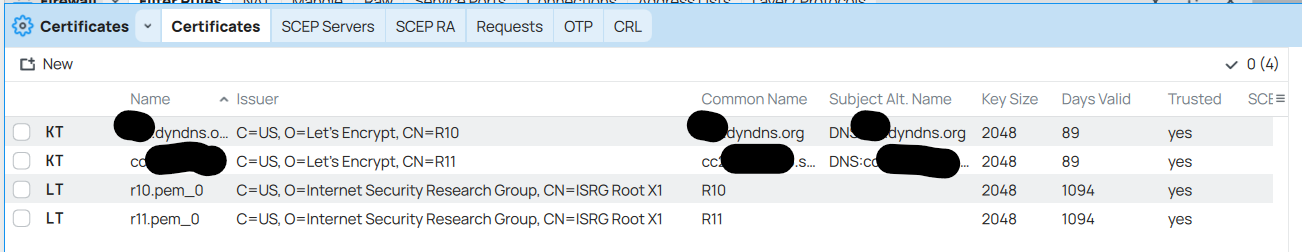

I removed the non-dyndns.org certificate and reinstalled the dyndns.org cert.
I went to sslchecker.com and it failed with instruction to open port 443 on the server.
I opened the port and it was able to verify the SSL cert is working using:

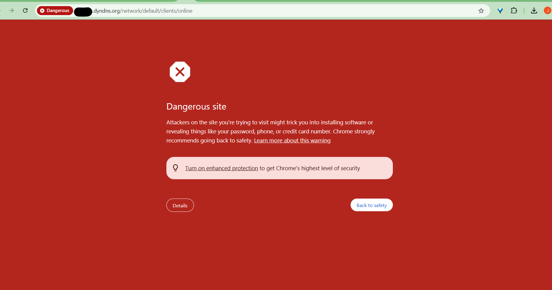

Of great – another new obstacle…errr…opportunity to learn.
This is the URL of UDM.
The “Details” will show you the certificate it thinks is unsafe. And the message is due the certificates YOUR computer is lacking the “root” certificate authority for your connection.
Basically you’ll get messages like that unless you’re using certificates signed by a “trusted authority”. As I mention above, what is a “trusted authority” is defined by the HTTP client. In the above, that’s Chrome… and the certificate the server is using is not “signed” by a “root authority” Chrome knows.
