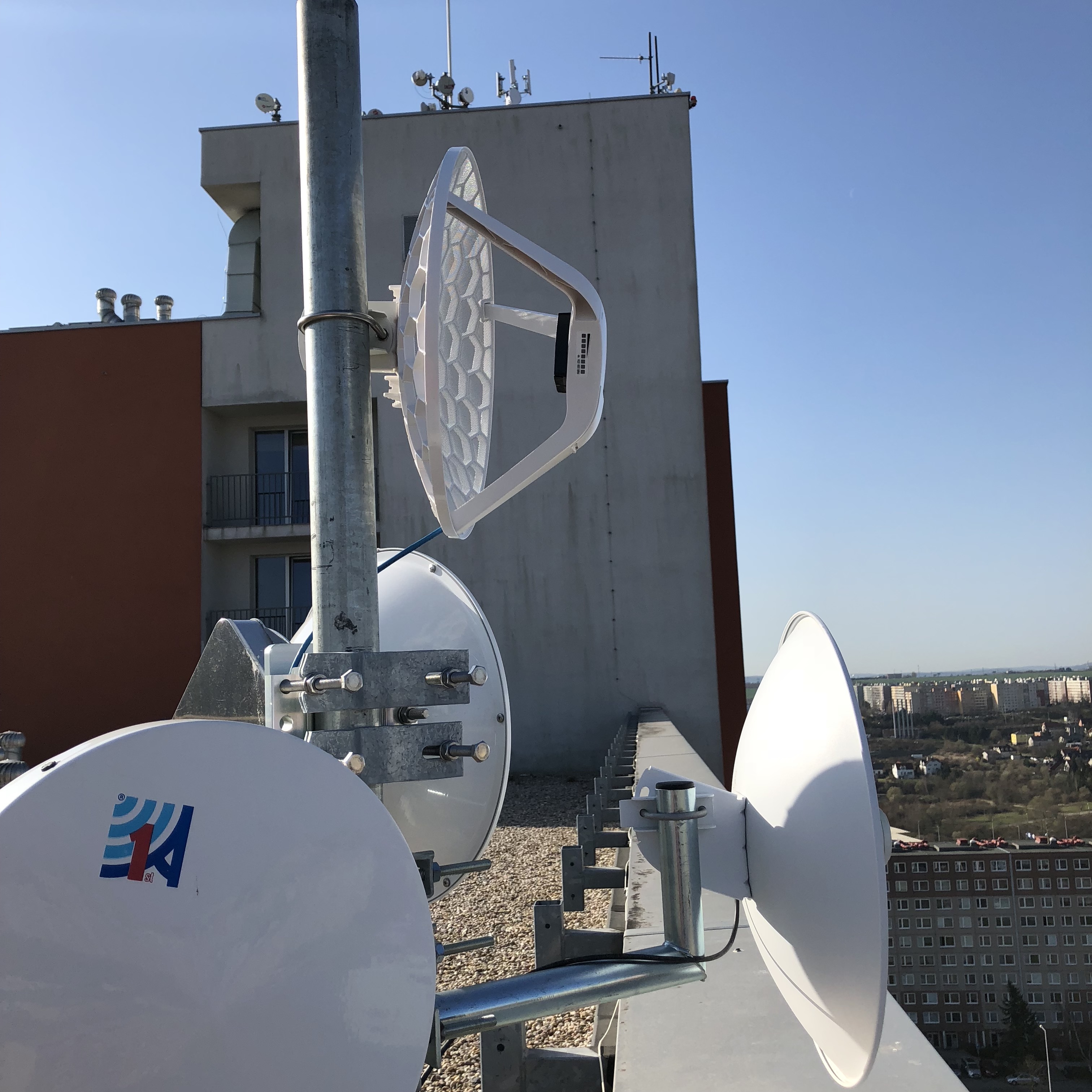

We are having installed link for 1200m, pretty good and clear link, I hadn’t believed it, but this piece of metal really kicks ass!!

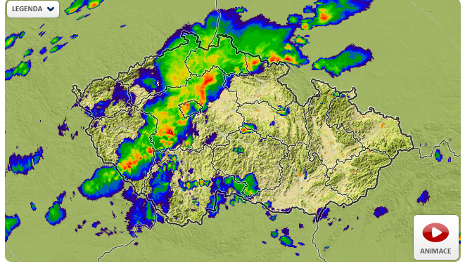

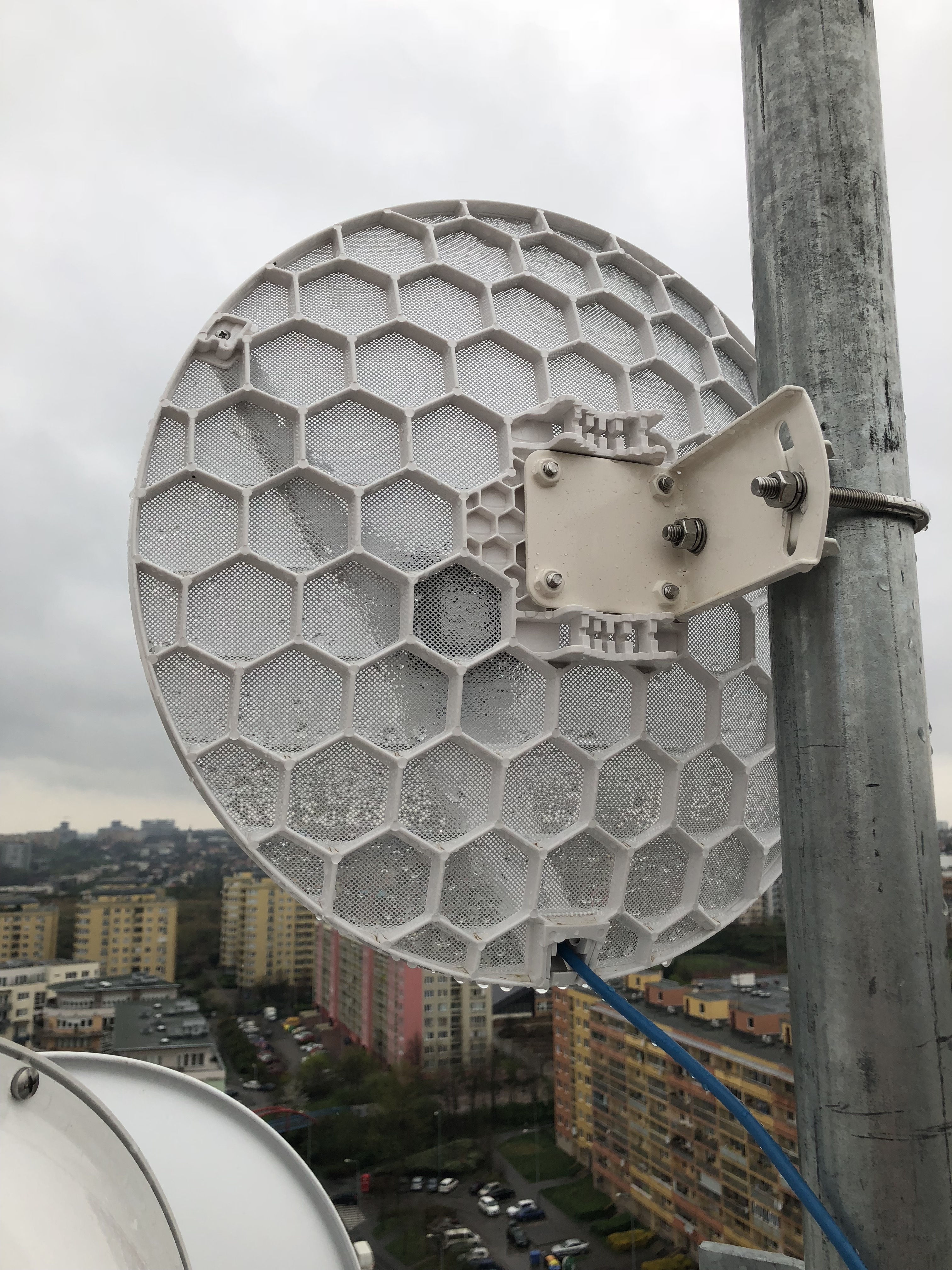

Rain rain rain.. We need more real live testing. But.. Todays situation about 40-45mm/h link was down for 4 minutes going from -56 to -70 in few seconds. The wet antenna takes -4dB!! Link length 1300m.
The link nearby with WAP for 400m was doing well all the time loosing approxiamtely 1-2 on RSSI scale looding from -66 to -68, and already working as before the rain. LHG is 15 minutes after rain still -59 and once dry has to come up to -56.

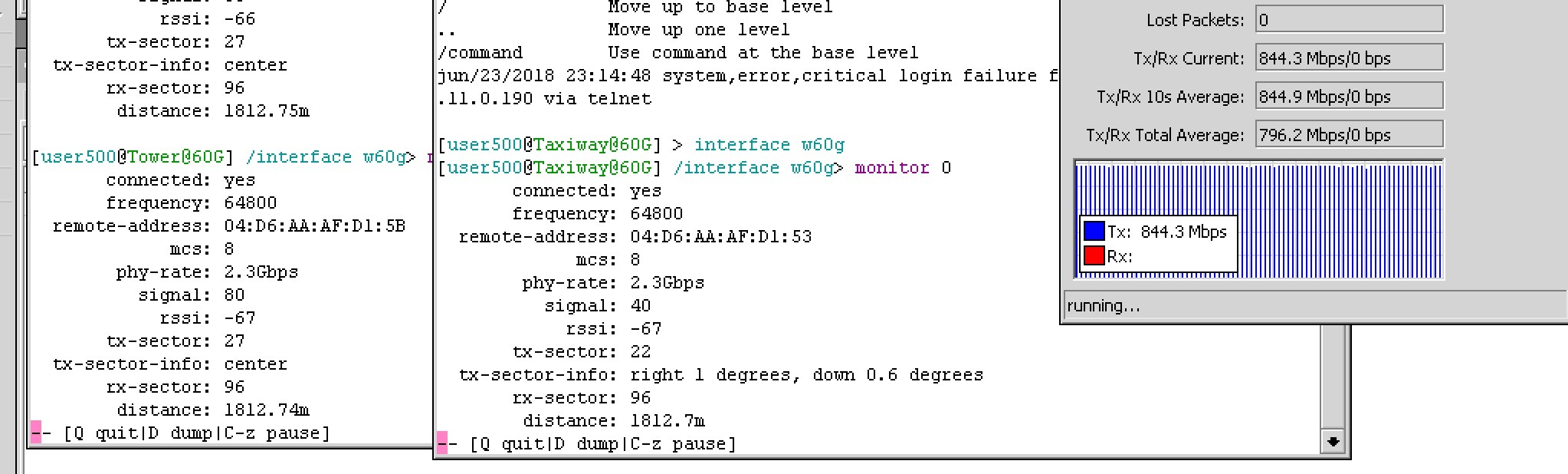

400m link, ROS 6.42.4:
1st side:
[admin@MikroTik] > /interface w60g monitor 0
connected: yes
frequency: 58320
remote-address: XX:XX:XX:XX:XX:XX
mcs: 8
phy-rate: 2.3Gbps
signal: 95
rssi: -53
tx-sector: 45
tx-sector-info: right 0.6 degrees, up 0.6 degrees
rx-sector: 96
2nd side:
connected: yes
frequency: 58320
mcs: 8
phy-rate: 2.3Gbps
signal: 70
rssi: -64
tx-sector: 58
tx-sector-info: left 0.6 degrees, up 1.4 degrees
rx-sector: 96
MCS and also signal is VERY unstable when link is under load, signal is jumping between 20 to 100 approx. each second, same as MCS - between 1 up to 8
Also, after a load, MCS will remain at low values 1-2 same as signal - from 80 before load to only 20 after a load

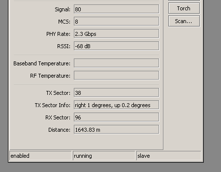

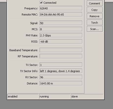

Here our results on first long link
Hello ,
our first long link. Great !!! firmware 6.42.5
Try to set channel to 64800 in CLI, the attenuation in O2 is smaller in higher frequency
