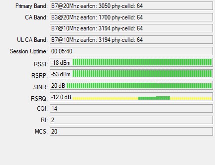

The MCS goes from 0 to 20 with random numbers (0,1,2,3,5,20)

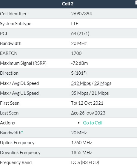

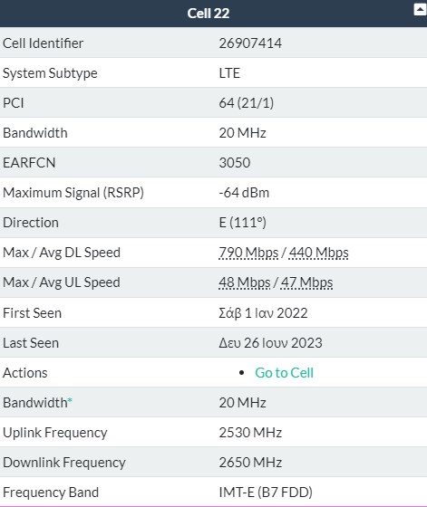

I ll try to get better position in Cell 22 (photo 1) B7 band which has better average download speed and try to cell lock it to see if i manage to have more stability in speeds through the day!
