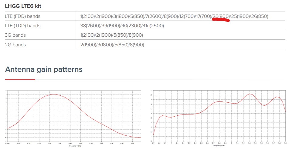

I own LHGG LTE6 kit with R11e-LTE6 modem.
It seems that this modem does not like band B20. It simply has low SINR at band B20. Can turn antena to any dirrection I want. It simply does not work as I would expect. But it works perfect at higher bands.
Signal example:
Band B20, RSRP: -87 dBm, SINR: 8 dB, RSRQ: -11.0 dB, CQI: 11
Band B3, RSRP: -87 dBm, SINR: 24dB, RSRQ: -7.0 dB, CQI: 15
It simply seems that modem is better optimised for higher bands. If your provider does not turn of higher bands at night time as my does, I would recomend to use higher bands only. You have to test it for your own if it works for you.
https://i.mt.lv/cdn/product_files/LHGGLTE6kit_201133.pdf
800MHz is 5 dBi only. versus 20 dBi for higher freq.
