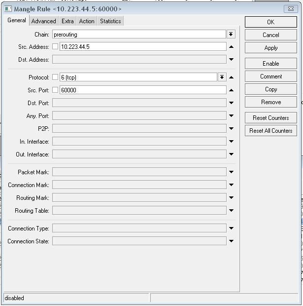

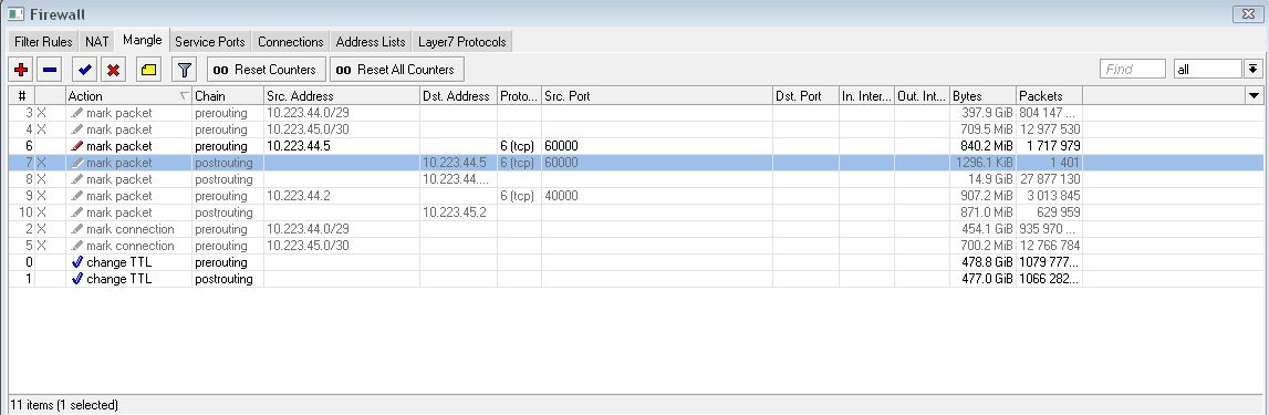

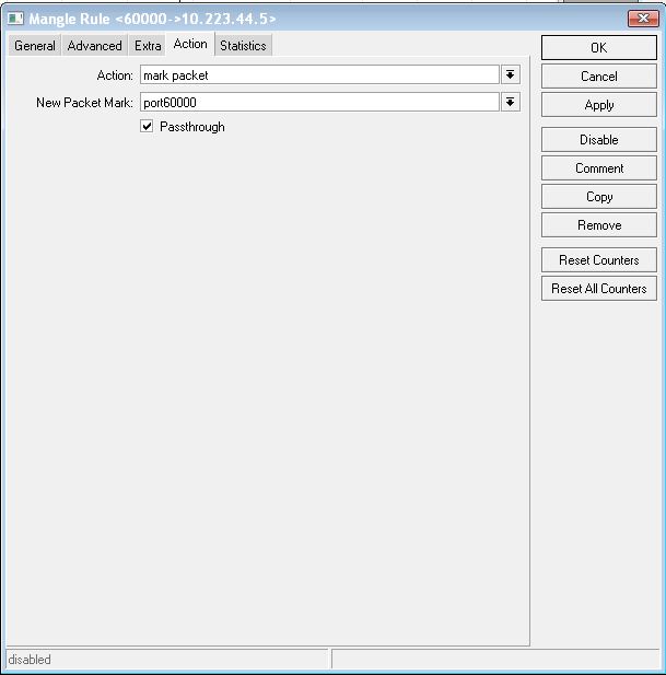

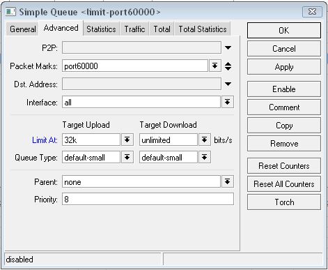

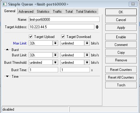

I’ve marked the packets, and added the queue, but things don’t work as expected. The upload speed still has some burts, and at the same time, the download speed drops severely to bytes/s.
1,2,3-packet marking
4,5,6-adding the queue

add action=mark-packet chain=prerouting comment=“” disabled=no
new-packet-mark=port60000 passthrough=yes protocol=tcp src-address=
10.223.44.5 src-port=60000
add burst-limit=32k/0 burst-threshold=0/0 burst-time=1s/1s comment=“”
direction=both disabled=yes dst-address=0.0.0.0/0 interface=all limit-at=
32k/0 max-limit=32k/0 name=limit-port60000 packet-marks=port60000 parent=
none priority=8 queue=default-small/default-small target-addresses=
10.223.44.5/32 total-queue=default-small
Upload/download is from the point of view of the router. Upload is traffic TO the target (so, from the client’s point of view, download) and download is traffic FROM the target (so, from the client’s point of view, upload).
http://wiki.mikrotik.com/wiki/Manual:Queue#Simple_Queues
direction (One of both, upload, download, none; default: both) : allow to enable one-directional limitation for simple queues (disable other direction)
  • both - limit both download and upload traffic
  • upload - limit only traffic to the target
  • download - limit only traffic from the target

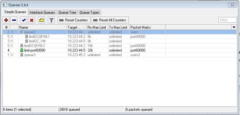

However, there is also something else that I’m doing wrong, because after I added the limit to the download instead of upload, I get no input on the graphs, everything is on 0 bps.

The prerouting chain should be fine for your purpose. Are the byte and packet counters increasing on that mangle rule?

add burst-limit=0/32k burst-threshold=0/0 burst-time=1s/1s comment=“”
direction=both disabled=no dst-address=0.0.0.0/0 interface=ether2
limit-at=0/32k max-limit=0/32k name=limit-port60000 packet-marks=
port60000 parent=none priority=8 queue=default-small/default-small
target-addresses=10.223.44.5/32 total-queue=default-small
yes, the packet counter is increasing on the selected mangle rule.
