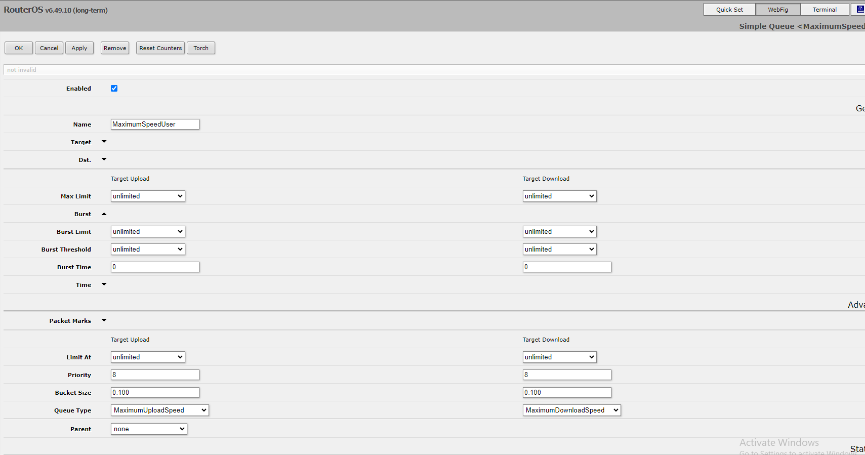

Now i want to limit the maximum download and upload for each access point.
The way i am trying to do this
1)create queue type pcq rate 10 dsc address tick.
2)create queue type pcq rate 10 src address tick
3)create simple queue and on advanced set target download and target upload the on queue type i set the 1 and 2 i created above.
My plan was to do this to all 7 IP’s since i want to set difference speeds to each access point but i fail to do this.
Am i doing something wrong ? And what is the simpliest way to just limit the upload and download for each access point ?

Thank you so much for your help. It's not exactly clients. I just live in a building that has 7 apartments and 1 router so we installed 7 access points so each apartment has internet.
Here is the file

It seems you added the queues in the APs side, I allways add the queues in the router, I dont know this should work as IMHO your APs are like switches connecting together wired and wireless clients (When I say “client”, I mean workstations, mobile phones, tablets, etc)
The APs are not the default gateway of the clients
The problem is that your router probably does not know which client belong to which AP, as they are all together, I can not be sure because I did not see the router settings.
One option is to configure VLANs but maybe this will be difficult
Another way is to configure APs as routers itself and set the queues in the main router but also this is difficult to be done by someone new in this
Anyone knows if queues work on bridged APs?
Regards,
Damián
Given the context, this seems to be the best approach.
Separate all traffic per AP and then queue can be done without problems on the router.
I think it can also be done using queue on AP with interface as limiting factor (not subnet).
But VLANs are for me the correct way forward.

It is not so easy, this could help to start:
https://help.mikrotik.com/docs/display/ROS/VLAN
You should do the following:
In the Router/Firewall:
  • Configure a VLAN for each AP, each one with different VLAN ID, each one in the interface where the AP is connected
  • Configure an IP for each VLAN
  • Configure a DHCP Server for each VLAN
In the APs:
If you have only wireless clients, you could just add the VLAN tag in the wireless settings
If you have wired and wireless clients, this will be more difficult.
After this, you could apply the queues in the router/firewall, for each VLAN as target
Other way, if you dont want to know hoy many clients has each AP, and if you dont need to have control over APs, you could configure each AP as Router, then you should apply the queues in the router for each AP IP address as target
