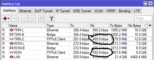

Balanceo Exitoso…!
Gracias
Load balancing successful…!
Thank You
