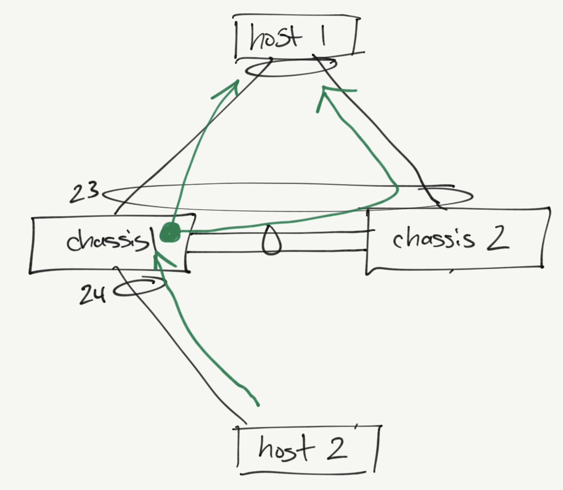

The orphaned LACP is “lacp24” the one I want load balanced is “lacp23” - they are 2 different LACPs. Putting the question differently - if I have traffic come in on a single port, how do I get it to load balance across a MLAG ?

Pardon the hasty tablet sketch … this type of thing?
Yeah - that “will work” - host2 is an HP switch that has an ESX connected to it - the traffic is coming from 2 different subnet’s, so l3+4 should load balance it pretty well. I will also mention that if I disable the port on chassis 1 the traffic is load balanced across the ICCP LACP
Gotcha. You get all of your LACP load-sharing properties back by just adding another link to the currently orphaned MLAG 24. It’s just a LAG from the perspective of “Host 2” (which happens to be an HP switch which then has yet another standard LAG to your server).

You’re correct in that there is no direct relationship between the two on the Mikrotiks. In fact, unless you have more than one MLAG member on a given chassis, it doesn’t even apply any LACP load-sharing algorithm at all. This is paradoxically the preferred behavior so that your load-sharing works well end-to-end.
If the goal is to get some utilization out of both links to both Host 1 and Host 2, you actually want the Mikrotik boxes to not do any load-sharing of their own. Host 1 (whether they’re a host or a switch or whatever is applying the load-sharing logic) will pick a link to send on and then the Mikrotik will simply send it down the local link to Host 2. The reverse is true when Host 2 returns traffic: it picks a link and the Mikrotik will send it down the local link back to Host 1.
The only purpose of the interchassis link is to provide some connectivity in the degraded state where one or more of these links goes away.
The big picture is that a) you get load sharing across all four north-south links in the diagram without the Mikrotiks ever having to think about it, b) inter-chassis bandwidth is not a concern, and c) the end-to-end load-sharing result is basically identical to if you had Host 1 and Host 2 directly connected with two cables in a traditional LACP.
Perfect, that will give you what you want :smiley:
